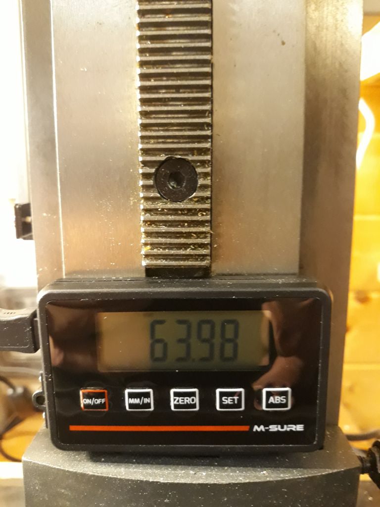

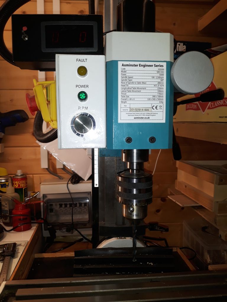

Gerhard Novak15/03/2021 20:37:09
avatar
109 forum posts
114 photos
Back to my single axis z-axis problem on the SX2. This is what you see when you in front of the machine
The depth indicator is well hidden behind the motor control. Lets have a closer look.
I have to say I am not acrobatic enough to read that while lowering the drill (not such a problem when milling, as you normally use the fine feed)
Solution: A cheap, battery powered single axis DRO. Now already in position. Using the screws which held the millimeter scale I need only one extra hole to fix the sensor in position. The brass strip making the connection between sensor and milling head is using the hole where the old, mechanical indicator was fixed.
And finally the screen. There are several possibilities to fix it, I just used the magnets on the back to fix it to the column. In case it is in the way I can always move it to somewhere else.And the DRO screen.jpg
This made my day, a quick fix for £30.

Gerhard,
Can I suggest that the display is not in an ideal place fixed to the front face at the base of the column. It's in a direct firing line for swarf/cutting oil etc, ti's up to you of course.

It is also sitting on the column stop. If drilling to a specific depth the stop is fixed with ref to the printed column scale to allow the desired quill movement with no risk of drilling too deep.
Gerhard Novak16/03/2021 12:29:46
avatar
109 forum posts
114 photos
Posted by Ron Laden on 16/03/2021 07:16:03:
Gerhard,
Ron, thanks for the hint, but I think this can be fixed with some transparent plastic sleeve
