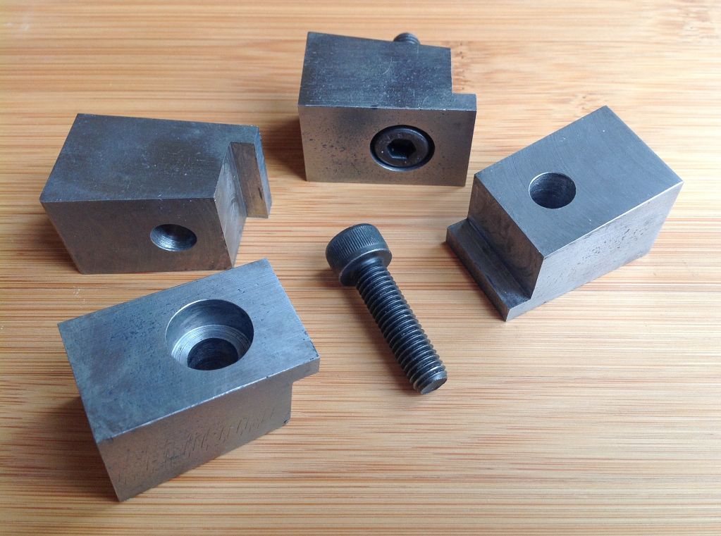

Vic29/04/2016 16:46:37
3453 forum posts
23 photos
I made some step clamps, perhaps a lower profile version of these would work ok?

John's suggestion of using an angle plate is ok if you have a decent length of table, but mine is only 460mm and I want to be able to use a tailstock, which would give a very restricted amount of space left in the middle. Vic's step clamps look beautifully made and a really good solution.
I posted the query originally because I thought I was missing some obvious method of fixing the table, I now realise you have to make it up yourself, which is fine, especially with all the advice received.
Chris
Vic30/04/2016 15:56:55
3453 forum posts
23 photos
I made those to suit my screwless vice but you could make some low profile ones for the RT. Probably come in handy for other clamping jobs as well. wink
