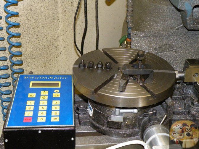

Posted by Bogstandard2 on 12/09/2014 09:11:51:
David,
If you want to have a go at making gears, then in reality you need to have an RT that can be fitted with a dividing setup. I think RDG sell cheap sets to fit both the Soba and Vertex 4" tables.
With regards to size of table, the 4" would suit you better for that type of job as the larger one as I would think you will be getting rather tight for throat depth on your machine. Besides, if you did need a larger table for horizontal work, you could easily mount a larger disk onto the RT, I have fitted a 9" plate to my 6" Vertex RT to give me more surface area.
So that puts one argument to bed straight away.
That's a nice looking plate John, where did you get it?

One of my concerns is the weight of the 6" unit, especially with a chuck mounted on it. I'm still leaning towards the Vertex HV4 to be used with my 4" four jaw or 4" collet chucks used on my Lathe. Johns idea of using a larger TEE slotted backplate leads me to believe it's a workable solution for me and the HV4. A 6" TEE slotted backplate should suffice and if I can't find one I have seen a couple of threads of folks that have made their own. This would also get round the 3 - 4 slot issue. The HV4 is also slightly more affordable. wink
Vic13/09/2014 14:01:09
3453 forum posts
23 photos
It does John, lots of food for thought there. yes
