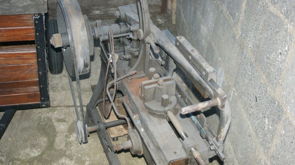

Last year I had to hacksaw through several blocks of 2" Square mild steel using just my "Armstrong" (which isn't quite what it used to be). As a result I decided that some form of metal cutting machine was really required. I looked at various metal bandsaws but I also recalled using a large power hacksaw at college (and how well it worked).
The upshot was that when I saw a McMaster power hacksaw advertised at an affordable price, I was tempted. Of course when the vendor switched it on, it sounded like someone was bouncing a tin bucket full of old bolts around! However, the price was right and it was clearly built like the proverbial brick outhouse.
This afternoon, the sun was shining so I decided to start cleaning up the disassembled bits (I had to take it to bits to lift it out of the car boot) and I spent a pleasant hour or so up to my elbows in soapy hot water, scrapping off the dried grease and hardened swarf. The hacksaw is clearly well worn in places but it occurred to me that I simply needed to 'adjust' my attitude towards the old brute. It's not a worn-out old machine tool after all. Once you start viewing it as "a part-machined set of power hacksaw castings" then I've probably got myself a real bargain!
laugh
Regards,
IanT

Well done Ian, a man after my own heart. Note the faceplate replacing cracked drive wheel.
Mind you I have yet to finish it!

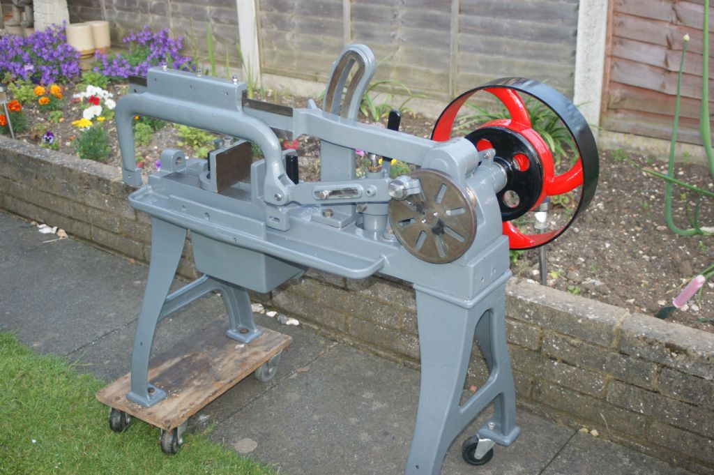

IanT11/10/2014 17:53:41
2147 forum posts
222 photos
My Shed hasn't seen too much of me this Summer (my Manager had other plans for me!) but I'm trying to get down there before it gets too cold again. Picking up projects after you've been away for a while is quite a challenge (particularly if you start off a bit scatter brained to begin with).
The last few days I've been trying to move my McMaster Power Hacksaw "project" on a bit. I managed to completely strip it down earlier this year and found various problems. The motor is in a bad way, with a lot of wear on the shaft. If I could MIG weld, I might be tempted to try a John S type of repair but I don't have a MIG welder and doubt my welding skills are up to that anyway. There are other problems (wear in sliding surfaces & bearings) that I can do something about though.
Having everything in bits, it was all cleaned and stripped right back to bare metal. I also built a wheeled trolley for it (as I couldn't move the base once the legs were bolted on - it's very heavy). That was about where it all stopped for summer.
I've now rebuilt the gearbox, repainted everything and started putting it all back together. I've decided I can probably get away with turning the worn 'gibs' (they are more like retaining strips) over and using the (less worn) reverse side (possible because the parts are symmetrical). Plus I've found what appear to be some small 'adjusters' that might help take up some slack..
Anyway - for lovers of Old Iron - here is the McMaster, hopefully looking a bit more respectable now. Still be a while before we can cut metal in anger with her but a very useful machine is starting to emerge from the rust!
PS Sorry but I cannot get the photos in the correct chronological order - but hopefully it will be fairly obvious.

John Baguley11/10/2014 18:25:21
avatar
517 forum posts
57 photos
Ian,
You might find it will move all over the place if it's on wheels, even if you can lock them. They tend to be very out of balance. I've got a smaller machine that sits on the floor and it has a mind of it's own once you switch it on! It really needs bolting down to a very heavy base (another roundtuit job!)
Nice machine though and you'll find it very useful smiley MIne's been a godsend.
ronan walsh11/10/2014 18:34:53
546 forum posts
32 photos
Sadly the problem with power hacksaws in industry is they get zero respect. someone has a job to do, they want to get the stock cut as quickly as possible to start machining or fabrication. They , in my experience, end up stuck in an untidy dirty corner and just used and abused , and apart from an occasional new blade, very little maintenance.

Circlip12/10/2014 10:02:31
1723 forum posts
Never ceases to amaze/amuse why many (with the excuse "I need to be able to move the -----" )put wheels or casters or both under a machine. "Safe" wheeled frames, the ones in which the wheelbase and track width is wider than that of the machine footprint and elevating the machine by about 1/2" (12mm) is rarely seen.
Best ones are the "New" range of combi Horizontal/vertical band saws. Even in horizontal mode the frame footprint is dodgy.

IanT12/10/2014 11:50:34
2147 forum posts
222 photos
Well the problem is that I do need to move it around Ian - if only to fit everything inside my Shed! smiley
My larger machines are placed pretty much where I can easily use them - that includes the two larger lathes (on their own benches), my two mills and the shaper. No wheels there - they do get moved - but generally on rollers with a wrecking bar, so it's not done very often if I can possibly avoid it. The workbenches are also fixed, as are the taller (Dexion) storage shelves.
My larger woodworking machines (Inca bandsaw, 10" saw & Coronet) are on wheels because I much prefer to make sawdust outside the workshop (same as grinding) weather permitting. They have some heavy bits/accessories stored on the lower shelves to help keep the centre of gravity down. They are 'parked' by the main door (with the 30" Hayter verge cutter) so can be moved outside easily in good weather.
Other 'wheeled' units include two large storage/worktop units, my Warco 12 speed drill (and now the McMaster) because otherwise it would be hard to fit everything in and still be able to move around. Most times - it is simply a matter of moving one or two units 4-5 foot sideways - as I'm usually only working in one area at a time. It's simply done when you've placed your larger items in such a way that other bulky stuff can be moved in and out of position down access lanes.
I take your point about spreading the width and keeping the height down but it does cause problems with 'bit's sticking out that snag when being moved. The wheels on the McMaster are right underneath its legs and it doesn't feel unstable when being moved. However, if it does prove unstable in use then it will have to be found a more permanent home without the wheels. But in the meantime - it's really useful to be able to move it around easily (just the base and two leg units are too heavy for me to lift).
As always, it's a matter of looking at any particular machine (it's size, weight, footprint, access required etc) and deciding what the best solution for it is in terms of ease of use/access versus stability/safety. All my larger/heavier machines are just sat on the floor (or benches) for this reason.

Clive Foster12/10/2014 14:51:16
3630 forum posts
128 photos
Power hacksaws do tend to suffer froim wanderlust. My 14" Rapidor used to move around 1/8" per inch of cut or thereabouts until I got fed up with pushing him back mid job and screwed an endstop in front of the base. I'd guess that was one case where my nice green "underfloor chipboard" flooring was less than optimum as its relatively smooth and flat surface didn't provide much grip on the saw base mounting pads. Plain concret might have been better but one would imagine that some effort should be taken to get it flat and well surfaced where the base pads go. If only three were in proper contact the resulting rocking might well promote movement.
My Far Eastern horizontal / vertical bandsaw sits on a purpose made rectangular box covering the full base area of the saw proper. Only the length stop and bar extend past the side. With small castors beneath it is sufficiently stable and provides a respectable amount of storage beneath the built in chip tray drawer. Second iteration as the standard pressed tin legs got seriously strengthened after the first attempt to move it by tipping back onto the wheels provided.
Watching the GP racing today I wondered if something along the lines of the quick lift lever jacks could be arranged to easily switch a machine from mobile mode to solid feet. In principle some sort of parallelogram link along each side of the machine with suitable linking stays would suffice to carry castors or other forms of wheel. Slipping the quick lift or other suitable lever under one end would jack the thing up into mobile mode. Naturally suitable stops would be needed so that the parallelogram link moves further in static mode than it does in lifted mode. I imagine such a device would be of considerable interest to MEW readers if someone were to take it on and demonstrate how to do it.
I have a hefty collapsing X frame made to use with a car jacking system which uses a simpler version of the idea whereby the quick-lift jack device simply raises the front far enough to let a pair of wheels touch the floor. Theoretically the device can be towed around via the lifing lever moving on the two rear wheels and the two closely spaced wheels on the jack device. In practice things are only marginally stable and its all rather hard work. Certainly not suitable for anything more than a few inches high. For a machine tool or anything else of reasonable height you'd need to do the job properly.
