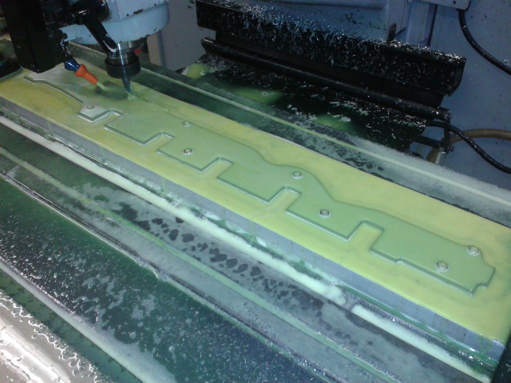

I am embarking on the construction of a 3,1/2" Evening Star locomotive which will be my first locomotive build.
My question is what material is best for the main frames? I'm struggling to find 1/8" bright mild bar wide enough (3.3/4". I have ground down several grades of 1/4" steel I had lying around, (bright, black, sheared plate and even the middle section of an old RSJ) but all had to be abandoned due to distortion.
my options as i see it are:
1. Locate 1/8" bar in bright or black steel. (any recommendations of suppliers welcome)
2. Purchase gauge plate (any recommendations of suppliers welcome)
3. Flatten out 1/8" sheared plate (again any recommendations welcome)
4. Use 1/4" material and compensate for this on the drawings

Option 5 use readily available 3mm sheet* or 3mm Black flat stock and adjust the stretches etc to suit the change in length.
You will have to do this with all plate on the older designs as sheet material is now sold in metric thicknesses.
Frames are not a good thing to make from Bright steel as it will tend to move when you cut out teh axle boxes
* Reeves sell sheared plate in suitable sizes for many loco frames or your local lazer or water jet cutter can provid ea couple of strips if you don't want them fully lazer cut. M-Machine do 3x100 Black flat

Jason is 100% right, use black 3mm plate. Bright or cold rolled steel has a nasty habit of trying to imitate a banana. I am not saying that black or hot rolled steel will not, but it is less prone to it. I once tried to stress relieve some 1/8" x 3" BMS, it had more umps and ollers than the rocky road to Dublin when it came out of the oven (not domestic) . It went straight in the scrap bin.

I really would like to make the frames myself and so have sheared off some more 1/8" plate which has come out flatter than previous attempts. Some manual handling should see these perfectly flat.
Thank you for the advice on the boiler, I am going to take the drawings to the next ME meeting and get the boiler tester's advice before any copper is cut.

Thank you all for the advice. I have now cut the main frames and am pleased to say they have come out flat. I used 1/8" mild steel plate and sheared the "blanks" leaving a good 2" all round. When the frames came off the mill the excess material was like a banana but thankfully the frames were perfectly flat. Whilst I had the "soft bed" bolted to the mill I also cut the Tender frames. next job will be the horn blocks.2014-02-20 09.28.31.jpg
