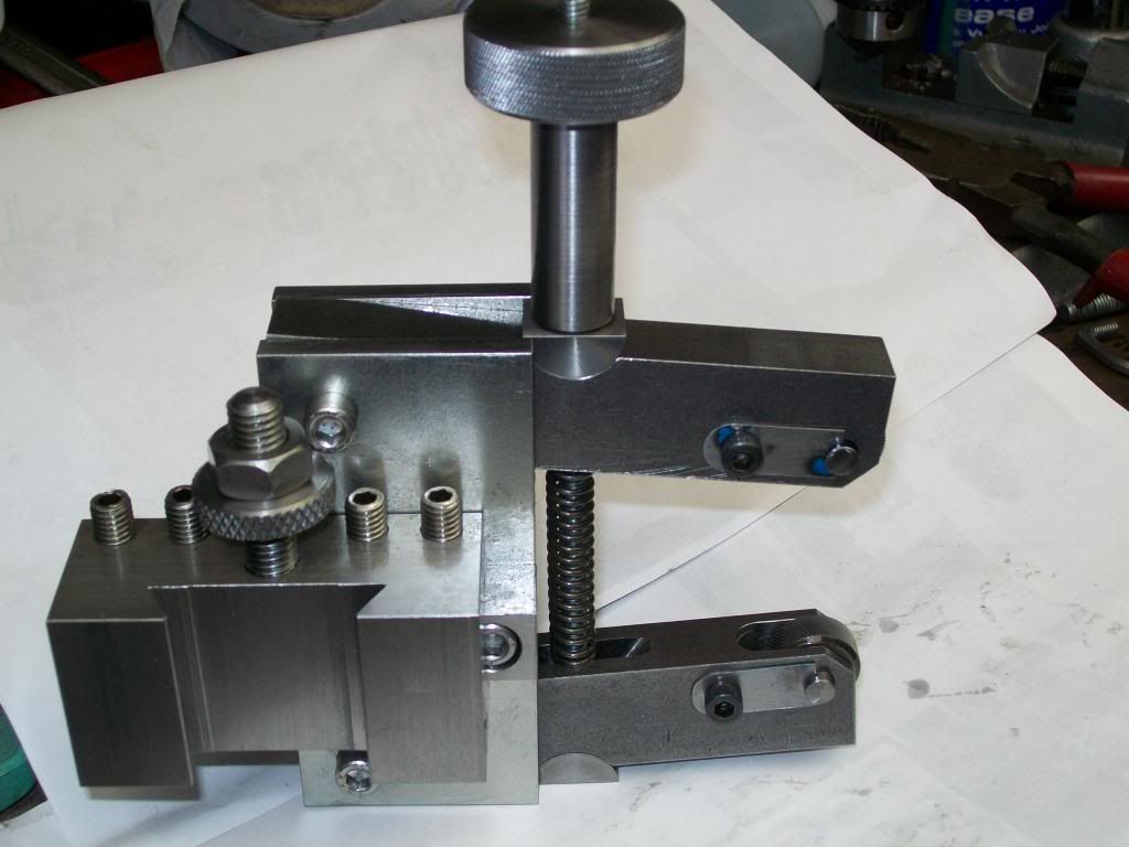

Stub Mandrel03/10/2013 14:51:13
avatar
4318 forum posts
291 photos
1 articles
I haven't got the face to post a picture of my clamp knurler after seeing Gray's. It was my first tool more complex than a d-bit, made around a bit of a broken display stand. It self centres and works, and now fits my QCTP as well. But it looks 'orrible.
To engrave my Meek-designed saddle dial I had to make a simple push in knurl, which worked fine - just a bit of bar with a fork in it and a hole for a spindle.

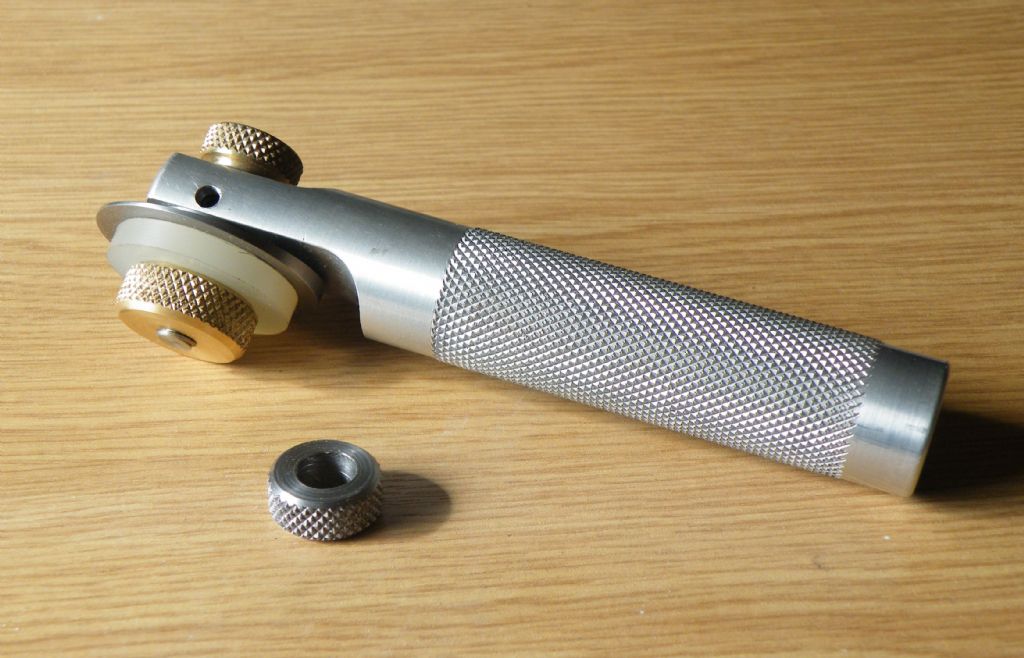

Gary Wooding06/10/2013 08:09:03
1074 forum posts
290 photos
Here's a knurler I made some time ago, together with a couple of examples of the results it produces. Full details of its construction were published in issue 72 of MEW.
