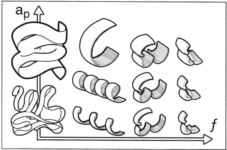

As has been said already carbide will take a fine feed with no problem and also sets of carbide tools tend to not be of the best quality.

Hello Martin, thanks for the answers. 1 - 3 bode well for success with carbide tools.
Re 4 - I was hoping you would be able to provide the designation for the tips themselves, rather than the toolholder shapes. Something like Sumitomo CCGT060202-NSC T1200A. It's the -NSC bit that's of particular interest as this identifies the geometry of the chip breaker arrangements moulded into the tip, which in turn determine the ranges of feed and depth of cut for which the tip is suitable.
If you haven't got that information, your answer to 6 provides some guidance - you were cutting on the edge of the tip's envelope, or a little out of it. Have a look at this diagram, cribbed from a Sandvik publication, I think:
Tips are designed to produce comma shaped chips that are easily removed from the machine, and don't clog things up, and they would produce such chips if being used within their intended feed and depth ranges. Longer spirals suggests you're slightly outside the range for the tips you have. That's generally ok, a bit outside the envelope (in any direction) works fine in my experience, but as you are having some difficulties it would be better to have the tip cutting within it's range for now. So adjust feed and depth until you find a combination that gives comma chips.

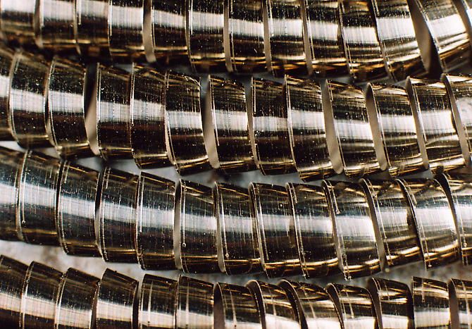

Pah! Call that swarf?
My record is over eight feet of tightly coiled stainless steel, that's real swarf.
<who won't mention that it was a somewhat shorter length of swarf that snaked into the control box and blew up the PCB on his mini lathe>.
Something like this?....
Yes, that's swarf. Nasty stuff, gets into lots of places you wouldn't want it to get into ..!!! I'll stick to chips with everything!
