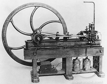

Hi all,
I like to make a model of a Lenoir engine. This is a double acting non compression engine designed to use town gas. I like to make this very early IC engine in a handsome scale with, like the prototype, electric ignition. As town gas is no longer available I have to use another gas like propane, carbide gas or even hydrogen.
Has any of our readers some experience with this type of non compression engines and wants to share this with me?lenoir engine.jpg

Lenoir used one of his engines to run a 3 wheeled carriage in the mid 1800s (a bit slower than walking) and used hydrogen as the fuel. Is nothing new as we are talking of hydrogen as the real fuel of the future for personal transport as well as for fusion energy! and here! wink 2

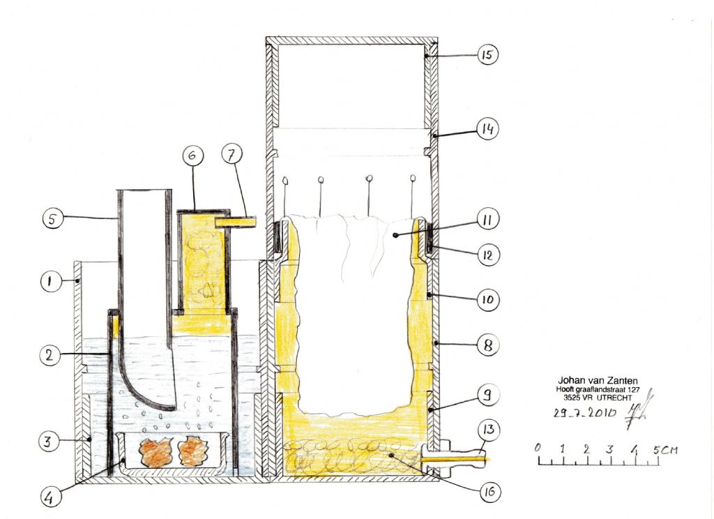

Johan van Zanten30/10/2012 09:35:47
avatar
52 forum posts
98 photos
Carbide gas develloper
Hi all,
To answer Charlie's question: In the Netherlands they sell carbide at the end of the year in some garden shops and it is used to "celebrate" the new year. ( you have to ask for mole exterminator ). I use it for some years to run my Otto and Langen engine. I made a developer from PVC drain pipe material and this works fine for a small engine. You don't even smell it. I don't have an English explanation for the numbers on the drawing at hand but I can translate the text if you are interested.
Regards, Johan.
