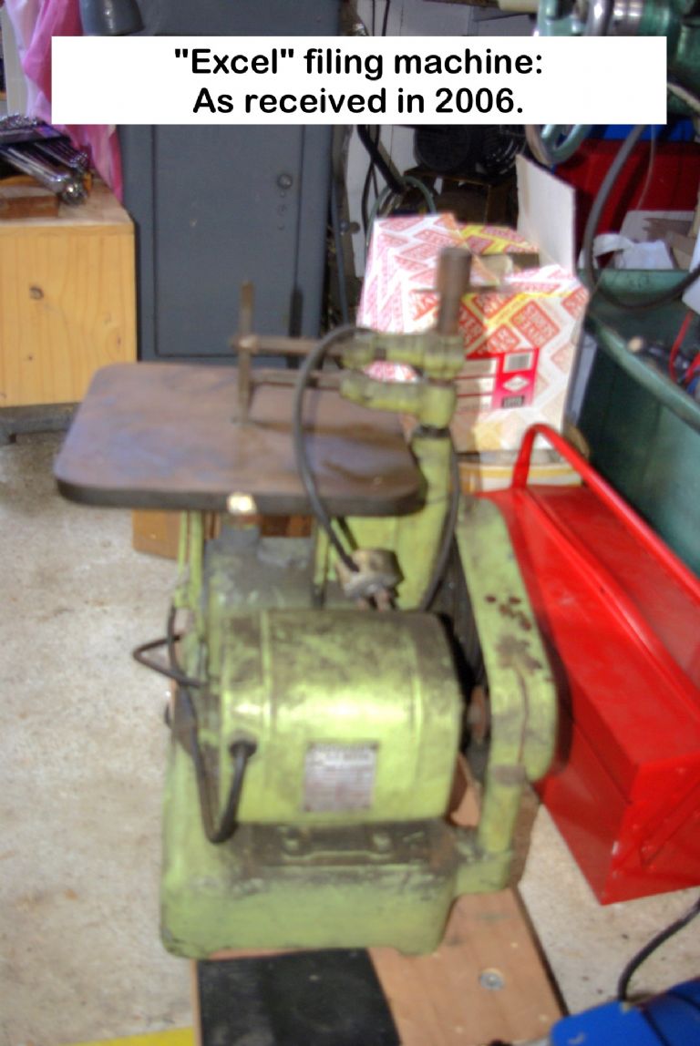

OuBallie01/05/2017 14:35:22
avatar
1181 forum posts
669 photos
This beauty made the square handles for the Boxford shaper.
A dream to use.
Excel Filing Machine
Geoff - Took me ages to find one.
Mike E.01/05/2017 17:25:12
avatar
217 forum posts
24 photos
I can relate to it....... "Took me ages to find one". Your Excel looks like a nice compact machine. It would be interesting to see a close up of how the upper end of the file is supported by the extended arm ?
