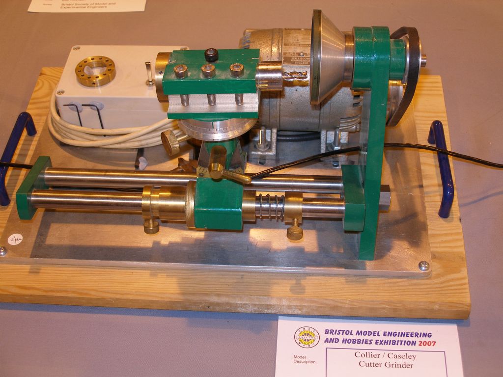

Hi There
The next MEW has an article on a superb little cutter grinder.
Looks easy to make.
Designed by a couple of people in the Bristol Society.
I will be making one.
Drawings will be available from the Bristol Society for £12.50.
No castings are needed.
regards David

David, I noticed a couple of potential issues abut the pictured grinder, based on my tool design experience.
1. the spindle bearing support is VERY short. This could lead to excessive wheel runout very quickly, and inaccurate grinding. longer spindles with a good distance between bearings (usually 4 x shaft dia min is a common rule of thumb in NA) are better
2. I hope way rod covers are planned or there will be very rapid wear of the rods, especially with bronze bushings riding on them.
3. belt looks undersize.
4. guard for belt is missing. machine is unsafe without a guard over the belt.
5. machine looks "wrong handed" unless it's for a lefty operator. If I'm looking at the back side in the photo somehow, the motor will be in the way of normal operation.
6. control box is right in the dust (not good for electronics) and behind the spindle. (dangerous to get to in an emergency)
JD

Hi There
You can make it which ever hand you wish.
I would reverse the hand I expect.
You can lengthen the bearings and fit way covers.
Buy whichever belt you want.
The box looks sealed and is well clear of the motor.
Feel free to fit guards.
Finally paint it
Green
regards david

David
I think that looks a great project, a much faster and easier build than the Quorn. It's ideal for the begiinner as there is plenty scope to easily add your own variation and "improvements".
It's easier to use ones own expeience to modify a design, it's much more difficult to orgininate a design (and keep everyone happy).
JD. part of the satisfaction is to add your own stamp onto a project, this design is an ideal starting point for developing your own inventive skills and ideas. I don't think ME needs to be concerned to much about intimate detail, leave it to the hobby to develop the initial idea as each individual sees fit, beginners will learn from that discussion and experience.
I think it looks fine as it is and will do the job intended.
My variation would be to raise the bed and have the motor underneath and perhaps use a poly vee belt and yes, make it right hand. May be I will make an epoxy-concrete base just for the experience and joy thanks to another thread on this forum.
I am sure there are plenty ideas to share.
Cheers
Nigel
Oh, BTW I will paint mine orange (how do you get coloured text?)

Does everyone need the complete words and music to make things ?
How may can look at a part / attachment and realise that if this part was modified it would suit the user better.
So far this grinder hasn't hit the news stands but it's already being trashed, now I can understand anyone pointing out various points that may detract form how it works, the 4th axis argument that was put forward by Tony Jeffree and myself is an example.
However once you know these pitfalls it's a simple thing to modify to suit or is it that some / most people can't manage to do this and with a T&C grinder there will never be one machine suits all
I saw the picture of this in MEW as part of what's in the next edition. the bit that stuck out to me was the end of the bed was unsupported. No problem, if I was to build one I'd just make a bracket, no big deal.
If you can't visualise and adapt then you ought to take up knitting, they have better instructions.
John S.

Hi John, could not agree with you more. I too saw the picture on the next edition page, and thought I would make a support bracket for that unsupported end. I'm sure this machine was tried by those who designed and built it, and undoubtedly it works OK as is.
I don't myself always have ideas to produce something out of the blue, but to modify something or use different materials/sizes or even add a bolt on, no problem. I've done this even with commercially made industrial machines. Of course sometimes bits can even be removed to improve its suitability for ones own needs.
Regards Nick.
