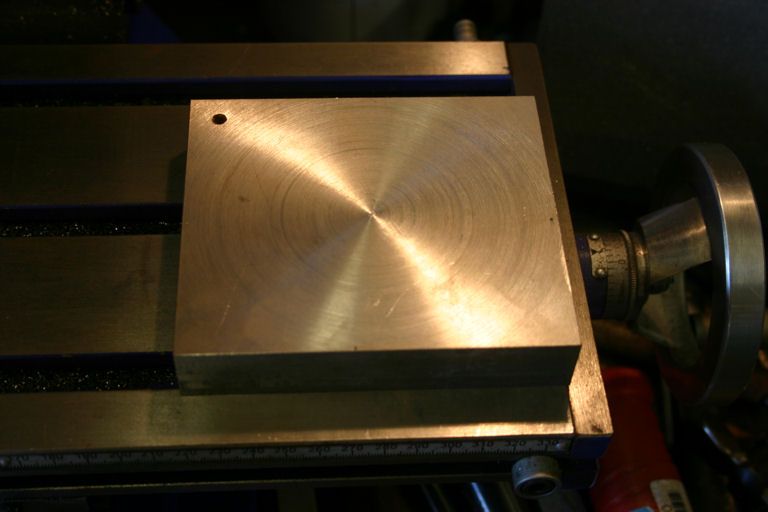

Don't know about the small stuff, or using HSS tools, but hot rolled turns fine with carbide, if the surface speed is high enough. As in this picture:
The block is 160mm square and was finish turned at 540rpm. This gives a peripheral speed of about 890fpm. The surface finish is about 1.8µmRa; not great but adequate for the job and not too much of a surprise given the tip had a radius of 0.2mm with a feed of 0.1mm/rev.
