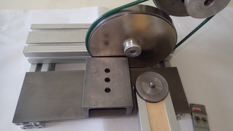

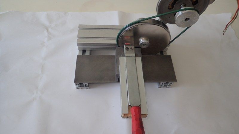

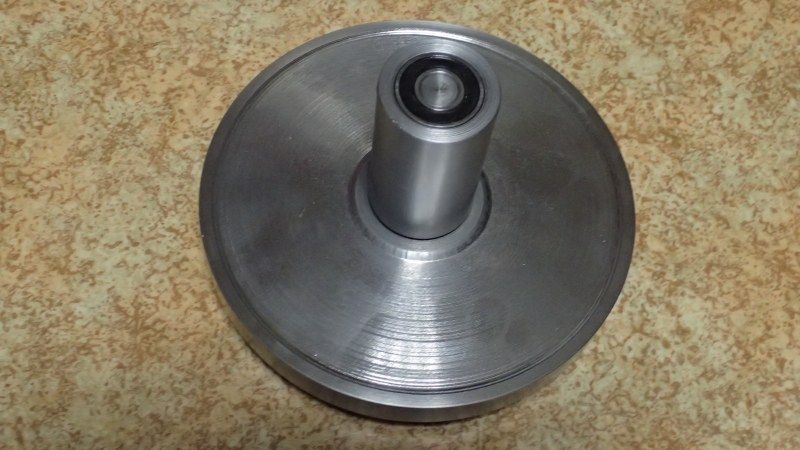

Build something like that 2017 to lap carbide scraper blades. I used 90W 2800 rpm furnace blower motor geared dow with round belt pulleys.
I used scraped aluminium profile for frame and build very simple spindle with two ball bearings that acsept 12 mm shaft. i glued one bearing (fixed bearing) and left another easy fit. All parts and materials from scrap box.
Work table is mild steel to allow fixing jigs there with magnets.
Different holes for different r (on scraper blade radius).
Plinth made of C-section mild steel is milled to proper angle (scraping blade needs small negative angle).
Slow speed works fine and even blade change is not too hard with knurled knob.
