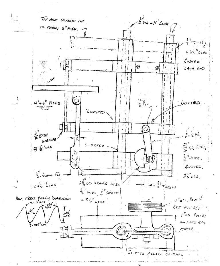

Howard Jones13/09/2010 16:39:56
70 forum posts
112 photos
Charlie
ockleshaw's sketch wasnt crude. we both built from it successfully.
 if I was to build another die filing machine I'd build the one described in Australian Model Engineer sept-oct 2010 (the current magazine). the renford style machine is built from steel sections and is impressively robust. the entire description is in the one magazine.
(sorry to be a phillistine David but ME was late in the shops. you'd be impressed by the design though)

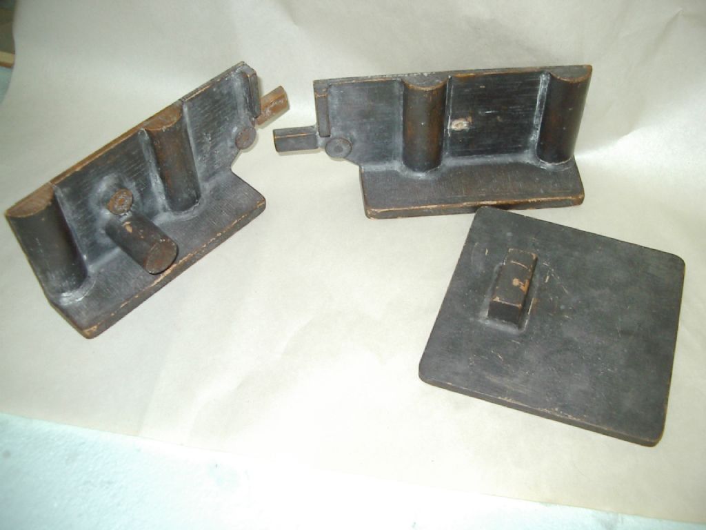

Howard Jones15/09/2010 18:47:30
70 forum posts
112 photos
axel
this is the sketch charlie was referring to.
I'll visit him tomorrow and we'll post some photos of the two moulding patterns.
basically if you sit the two arms down on top of the body you have the casting shape of the main body. these arms are sawn off the casting and then machined.
the other casting is for the table.
they are a copy of a swiss filing machine in the early 1900's.
Howard

Charles16/09/2010 04:30:56
5 forum posts
2 photos
Here are photos of the pattern
Here is the pattern split apart
