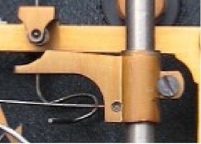

Many thanks Duncan, got them all of and look really useful reading. The latch in the book Electric clocks and chimes looks very similar to the one on the clock, perhaps this was an older style latch.
I'm really amazed how much info I've got in such a short time----many thanks to everyone on the forum

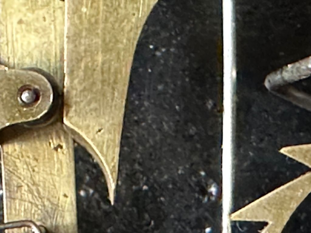

Thanks everyone. The impulse ramp looks different to other clocks when I search around also the latch arm which the "escape" wheel trips to drop the gravity arm. Sorry, cant rotate the 2nd pic!
Thanks for the offer Duncan---shall I PM you?
Peter

I've been trying to get a syncronome master clock going as an occasional project for a while. Previously repaired them with great success. The clock is set up according to instructions I've found and everything works as it should but as I suspect it was a home built version from Syncronome supplied castings I'm getting suspicious of some of the dimensions’ and detail.
I believe that Elliot Isaccs described building one in Engineering in miniature but cannot find it. Does anyone know of the issues or have access to them?
Thanks Peter

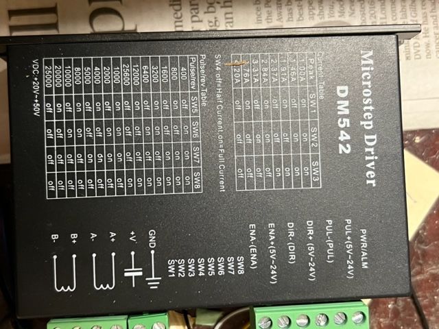

Many thanks for all the replies. Thought there was something basic I'd missed.
Driving it from an Arduino Nano and ended up using 2000ppr as its very smooth and working out at the right speed..

16/01/2023 14:50:24
I read the recent posts about TB6600 drivers with interest and why there were two 400pulse/rev settings.
On a machine I’m playing around with I’m using a DM542 driver with a Nema 17 motor and it runs cool, smooth etc.
My question.
The DM542 got all the usual multiple pulse/rev settings ie 800, 1600 etc but in addition it has lots of others, see pic (apologises, couldn’t rotate pic?)
These range from 1000 pulses/rev to 25000/rev---are they aimed for a specific use?
I always thought the basic 400, 800 range etc was possible as it used multiples of the stepper motor windings?
Finally, I’ve got a Nema 34 motor I want to drive can anyone recommend a suitable modern driver?
Thanks Peter
