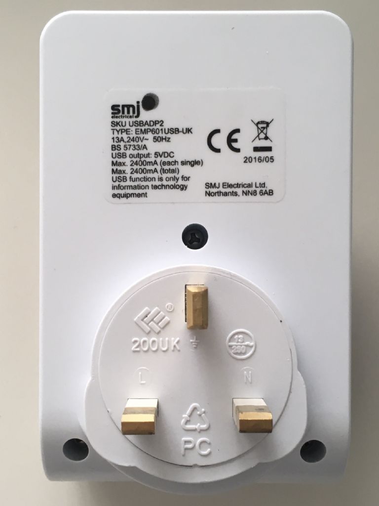

I bought this handy-looking adapter a few months back
The 13A plug fits rather loosely in my Mains sockets, and the USB sockets appear to be badly dimensioned [every USB plug that I have tried in them fits loosely]
Not recommended

Bit ambiguous: 2.4A each / 2.4A total?
So can it provide 4.8A divided by two sockets, or only 2.4A from either or both...?

Posted by Nigel Graham 2 on 30/04/2023 11:04:41:
Not ambiguous at all, Nigel … I think it’s quite clear from my photographs

More to the point is whether it complies with BS 1363 (which certainly does specify dimensions).

Posted by Chris Pearson 1 on 30/04/2023 14:21:51:
It makes no claim to dont know

Posted by Michael Gilligan on 30/04/2023 14:33:52:
Which was to some extent the point that I was making. If it is not certified to BS 1363, it should not be plugged into a BS 1363 socket, and a BS 1363 plug should not be plugged into it. It may even be an offence to supply it.
