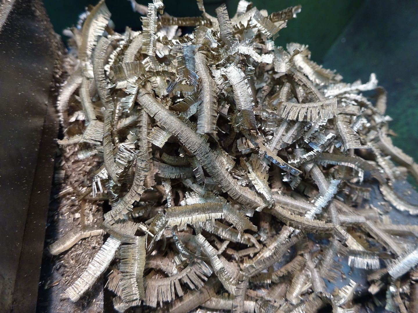

Castellated swarf:
And formed swarf from an insert parting off tool:
