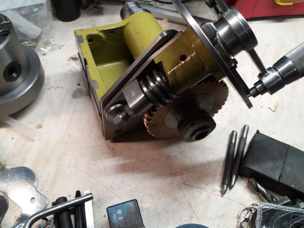

Posted by Peter Simpson 3 on 04/12/2022 10:31:23:
I'm looking to purchase a dividing head. looking at the net the only ones that are affordable are Vevor. has anybody purchased one of these ? Are they any good ?
There are lots of these around under different brand names, all probably from the same factory in China.
I have one with a 5" chuck, it seems reasonably well made considering the low price, the only thing I found was with the backlash adjustment which needed fiddling with every time I used it.
Here is the test report that came wit it
Edited By vic newey on 04/12/2022 11:48:05
Edited By vic newey on 04/12/2022 11:58:21

I have the BS0 Vevor wih 5" chuck - currently £224 with tailstock and three division plates, which is excellent value imho. The spring washer which bears on the sector arms is a bit rubbish, and needed some bending and filing off of sharp bits, and I stripped the head down and adjusted the bearings - I can't remember whether it has a separate adjustment for the worm backlash, but anyway, it was quite easy to get it working as near as perfectly as my dubious skills require.

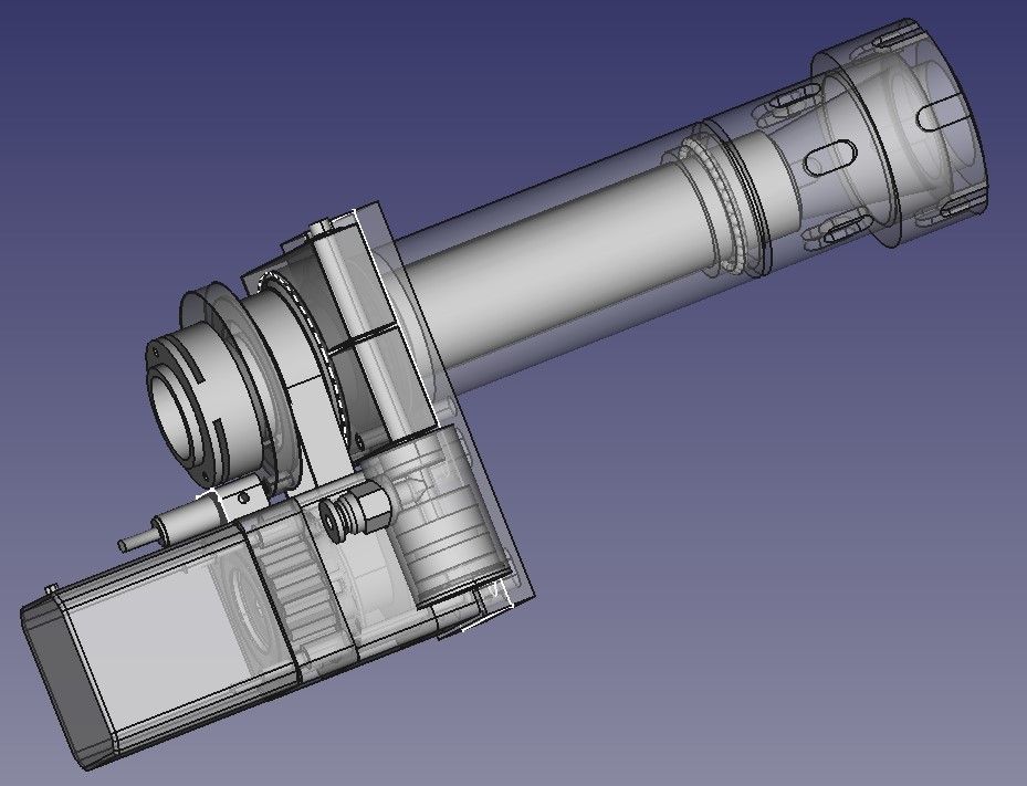

I have a 80 mm Saba rotary table. It was cheap (€ 60,--) and a peace of junk but I have used it for many years. I use the rotary table mainly for milling gears and hex nuts.
I build one (40 mm) that fits in my vice so it is ready to use in seconds. It is controlled by a Nema17 stepper (1:30 gear ratio) and locked pneumatically. I used 3 mm balls to make 45° contact angle bearings so the spindle is free of play. I fitted an ER32 collet holder for clamping 20 mm bars. The runout measured at the collet taper is 0.015 mm.
Once it is ready (documentation and video) I will publish a video and the (freecad) drawings. I estimate it will take about 40 hours to make one.

I got the Vevor with the 100mm chuck and think it is incredible value for money. How do they do it at the price?
I became fixated on the backlash and got it down to 0.1 degrees, worst case. Self-defeating because I cannot resist taking up the slop with a quick twist of the chuck before locking the spindle and it would probably be easier to feel 1 degree than 0.1 degree dont know
