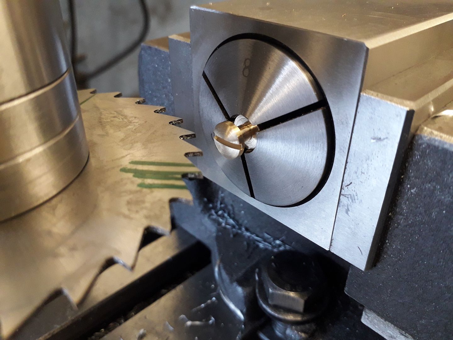

I am slotting some bronze screwheads for a friend. He modifies theodolites for non magnetic standards. All ferrous screws changed for bronze. He makes the screws and they need slotting.
I have a 2mm saw mounted on the mill vertical drive and screws held in the vice in a collet in a square johnson block.
What is best method of ensuring the slot is central,in the screw head.
I have a DRO fitted to the mill and readout system.
Hard to get a measuring tool into the setup to check. Any ideas please.
JasonB29/07/2022 19:55:45
avatar
25215 forum posts
3105 photos
1 articles
I tend to turn the saw back and forth by hand while lowering it and touch it onto the top edge of the screw head, you can do it by feel or with a fag paper. Zero the DRO at this point.
Now feed down by half the saw thickness plus half the screw head dia and you should be on ctr line

I'd try putting into the collet a throwaway piece of material same diameter the screw thread.. Cut a slot and then re-adjust the position by trial and error until it looks right. Then cut the actual screws; but I haven't got a DRO!

I find its a very trial and error process.
I too touch off in a similar manner to Jason but I use the upper and lower points (north and south) on the screw or workpiece held in a Stevenson block and then halve the DRO readings to find the centreline. Apart from the fact that it difficult to see or feel when the sides of the slitting saw teeth touch the workpiece, I find most of my slitting saws have some wobble so results are not always as I expect.
I sometimes true up arbor faces and spigot diameters in the lathe and without removing the arbor from the lathe, fit the blade and still get runout at the saw teeth. I could probably reduce the blade wobble by having a large diameter arbor that only leaves enough of the saw teeth exposed for the depth I intend to cut.
I find that with, say a 1mm wide x 75mm dia sawblade with a 38 diameter arbour if there is any wobble the slot position partly depends on which part of the blade circumference make first contact and makes a channel for the rest of the blade teeth to follow.

On the last gudgeon pin remover tool I made, using an arbor mounted 2.75mm diam saw in a vertical spindle, I bought the slowly rotating 0.50mm thick blade down to touch off the top of the 4mm diameter part held in a horizontally fitted indexing/dividing head, set the Z axis to zero, moved off in the X direction until clear then dropped the blade to below the part, raised the blade to touch off the part and read the Z readout, moved off the part again in the X axis and raised the head 1/2 the recorded distance. Set the spindle revs to 300 and using the X axis moved the blade into the work by the 10mm required with a feedrate of 30mm/min.
Using this method evens out any runout on the blade and gives a spot on centre cut.

Thanks Gentlemen, the sacrificial pin of thread diameter seems the way to go. I have over a 100 to do!

For this sort of job I prefer known error methods where a suitable test cut is made deliberately offset from the desired position and the actual offset derived by measurement and calculation allowing things to be adjusted to place the cut correctly on the actual workpiece.
Especially so if a DRO system is fitted as it makes compensating for the deliberate error in the test cut much easier than when using conventional methods.
For this job I'd make a dummy cheesehead "screw" and slice part of the head off leaving a D shape.
The position of the flat side of the D can be measured to appropriate accuracy hence establishing the position of the lower side of the screw slot produced at that vertical position of the slitting saw.
Given the diameter of the dummy "screw" head and measuring the depth of the D the offset needed to put the bottom of the slot to be cut in the proper screws exactly half the width of the screw slot below the collet centre line can be calculated.

I use a DTI, zero it on the part then adjust the cutter height using the DTI. Add 1/2 the thickness of the cutter and part you are at the centre.
If you revolve the saw you can compensate for the wobble too.

I did a similar job some time ago, using a chuck mounted on my rotary table.
Set the saw height by eye, made a cut across the blank, then turned it 180 deg and made a second cut.
Any error was soon revealed and corrected.
