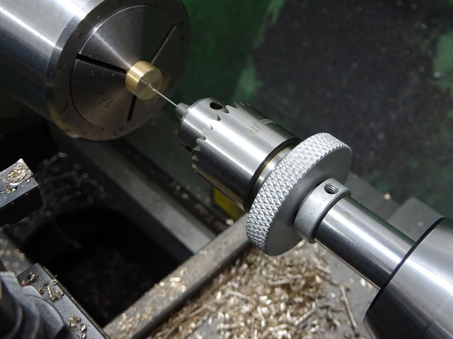

All, the smallest tailstock chuck I have for the ML7 is still fairly large and heavy. Although it closes to pretty much nothing, I sometimes have to put a pin chuck in it for very small drills. Obviously this increases overhang, reducing accuracy and stiffness just when I need it.
Can anyone recommend a very small Jacobs type chuck with an MT2 taper? Preferably keyless, but anything considered so long as it’s accurate and securely closes to about 0.25mm diameter minimum.
Thanks.

I've use one of ARCs little sensitive holders and a chuck to do 0.3mm hole so should be OK for your 0.25mm ones too.
Regularly use their "heavy duty" ones for 0.8mm holes too.

IanT27/01/2022 17:52:56
2147 forum posts
222 photos
Arc sell a range of MT2 tapers with various tapers on the nose - and the chucks to match them.
I also purchased a 'sensitive' drill but frankly felt that the drill shaft was far too loose in it's body - so I remade it as mentioned a week or so back. However, I think it's worth pointing out that you don't really need this kind of drill holder (with knurled bearing) as when used in the tailstock, it doesn't need to revolve.
You could use any small chuck and just make a sliding shaft into an MT2 blank arbor.
The knurled bearing is required if you use it in a drill or mill - as then the body does spin. This 'sensitive' type of chuck & holder is also useful if you have a small horzontal mill with a vertical head that has no 'quill' (so drilling has to be done by raising/lowering the table). My re-built version has a reduced 10mm shaft end, so it can fit in an ER16 collet and be used on my Taig milling head.

So the Arc chuck and collar is fixed into a larger chuck in the tailstock, and can be extended and retracted by the collar? And if fitted into a mill or pillar drill, the chuck rotates but the collar stays loose, and can still be extended and retracted?
Sounds spot-on, but ideally I’d like to fit it direct into the MT2 taper to get it as short as possible. Can the straight shank easily be replaced with a taper? Then I’d have both options?

Yes you have the operation right.
Has the Myford got a through hole so you could use a MT2 x 1/2" collet

Posted by JasonB on 28/01/2022 07:19:19:
Yes, the tailstock MT2 taper is hollow if that’s what you mean? Presumably I’d need a draw bar then? Thanks.
