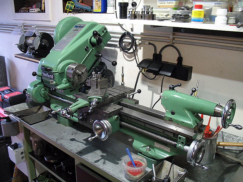

Just acquired a Myford Super 7 to replace the rather careworn ML-10 I had been using.
The Super 7 dates back to '96, but appears to be in fairly good shape for all those years. It doesn't have a quick change gear box, but does have power cross feed... and it came with all sorts of tooling.
Anyway, as a first time Super 7 owner I've just a few questions if anybody can help...

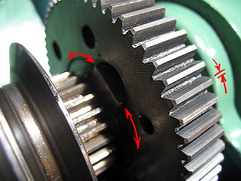

(1) I've run a few test cuts, entirely by hand feed, with the gear train to the lead screw disengaged. What I've noticed is that there appears to be a subtle noise that comes from the toggle link that connects the main spindle to the drive pulley stack.

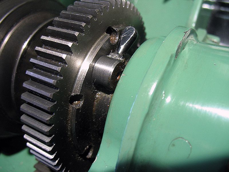

The toggle engages as it should and the lathe cuts cleanly for all that, but I sense that there is a slight backwards-forwards rotating motion of the spindle that makes itself known as a subtle click-clack when I change the amount of feed applied to the cutting tool.
There is obviously a wee bit of play in the connection between the toggle link and the bull gear. This play (in a rotational sense) is equal to perhaps a third of a tooth width.
What I'm wondering:
  • Is this normal for a Super 7?
  • Is there anything I might do to damp down this noise/motion?
  • Does this indicate wear in other areas that should be investigated?
This little bit of noise is annoying, but for all that, the lathe appears to cut as it should, without any undue play or runout.

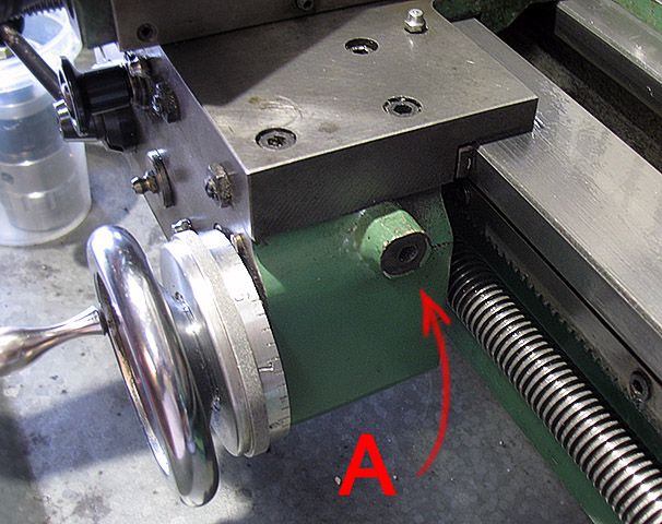

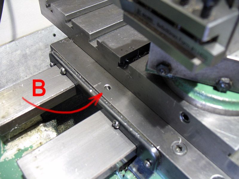

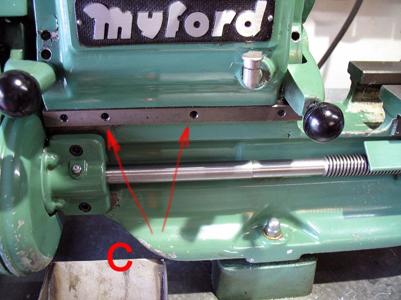

(2) I need to purchase some screws for mounting bits of this and that, but have no way to identify the correct threading required.
I have a copy of the Super 7 Operation Installation and Maintenance handbook, but it provides no information regarding the particular bolts/screws that I need.
So, perhaps someone can tell me what screw/bolt threads are appropriate for the following locations as indicated in the following photos:

Bolt Hole A is for a screwcutting dial indicator. Hole B is for a travelling steady. and holes C are for the screwcutting gearbox. Google the above for photos of them. If you're going to be doing any screwcutting you'll need the indicator.
Yes, there is generally a little play in the toggle link. It shouldn't be of concern.

I can't comment on the thread sizes, however I have the same noise problem from my S7 (same model as yours but made in 1999). The only way I've managed to reduce the noise is a small blob of grease where the half-circle of the toggle locates into the gear.
Hope this helps.

On mine A and B are 1/4BSF,can’t help with the others I’m afraid

Mines the same model but older (1979) - don't ever recall any noise from where you suggest so can't help you there but as far as I'm aware all threads are BSF
Looks like you have a very tidy and clean workshop there - impressive wiring conduits yes but personally I wouldn't have the off hand grinder so close to any machine ways if there's an option to have it elsewhere. It's not the grinding dust sitting around the base of the grinder but the carborundum fine dust that floats over a wider area to be concerned about.

My Super 7 is about the same age as Tug's and all the holes indicated on your photo are 1/4" BSF on my lathe.

Regarding the Backgear Toggle high speeds tend to throw the lever outwards allowing it to touch the headstock casting every revolution if the detent is not crisp in action. See the following link
**LINK**
Items 4, 81, 82 and 7. Either the detent dimple gets worn or the spring is not strong enough. It's annoying but not fatal. I did manage to fix mine on the old Myford. The new one is OK thus far.
regards Martin

I just checked my Super 7 (1976) and, although I have never been aware of it, there is some play in the bull wheel, about .010" at the periphery of the gear. As far as the threads go, as stated above, "A" is for the thread dial indicator ( on mine a 1/4 BSF stud and nut), "B" is 1/4 BSF for the traveling steady, and "C" for fixing the quick change gearbox (on mine this is M6x1.0).

My MLS7 is older and grey like its owner! (1971) It has BSF threads all rounds except some locations that call for something smaller than 1/4"BSF, where 2BA has been used. The leadscrew brackets, felt wiper brackets on the left hand side of the saddle, retaining screws on the ends of the changewheel spindles and there could be more.

Sorry for two unsolicited comments in addition to suggesting you have a good looking Super7B there.
(1) What size bolts are employed to hold down the lathe onto the raising blocks? From your photo it appears there are small dome nuts which I'd suggest are maybe inadequate to ensure it's secured level for prolonged use. The S7 bed will flex more than your previous ML10 and truly accurate levelling is really important.
(2) If you have the original "V" belt driving from countershaft (i.e. a solid, continuous belt) then replacing it with a multi-link belt (e.g. Brammer) will not only make for a smoother running & cutting S7 but will also reduce that "subtle noise" you hear.
Is that a "zero-able" dial on the carriage hand wheel? Why?

Many would query the wisdom of the use of link belt on the myford lathes ! Bolts are 1/4" BSF I have bolts in lenghts from 3/4" to 4" if you need them. Spindle lock is hidden behind the change wheel guard, took me 10 years to find mine. Good luck, Noel

I agree about the grinder being close to the lathe, perhaps it just lives there out of the way and gets used elsewhere .
I always try and do any grinding outside and never in the machine workshop .

Reading through the posts it seems Myford may have changed the screws that secure the gearbox from !/4 " BSF to M6 at some point. OP might be best to check his machine.

I think that what you call the toggle link is the back gear key in Myford speak. Mine certainly has some rotational play but I can't say it's a problem in practice. An associated point is the importance of lubricating the spindle via the nipple in the pulley.
I believe that Myfords did use some metric fasteners in later production, an example being the big-headed cap screws securing the saddle to the apron.

Yes, there is that little bit of play in the backgear toggle, but like I said it doesn’t seem to affect anything and if it really bugs me in the future I can always add in that gob of heavy grease (thank you Mark Barron) or else jam in a piece of toothpick to (?) take up the play. That backgear toggle works very crisply and I suspect its spring is plenty strong enough to prevent it from spinning outwards at high(er) speeds. Thank you Martin for suggesting that I should check it out.
After cleaning some old, accumulated swarf from out of those three holes and testing with some drill shanks I am fairly satisfied that all are threaded the same… which Rod Renshaw indicates as being ¼” BSF. On the strength of that I’ll order those screws and (gently) try them out for size.

Oh and, yes, now that I have such a nice lathe it is probably time to move that grinder to some other location… just to be safe. Of course, I tend to do some angle grinding work as well as a touch of woodworking and such in my garage so a really good cover for the lathe is also on the “must obtain” list.
