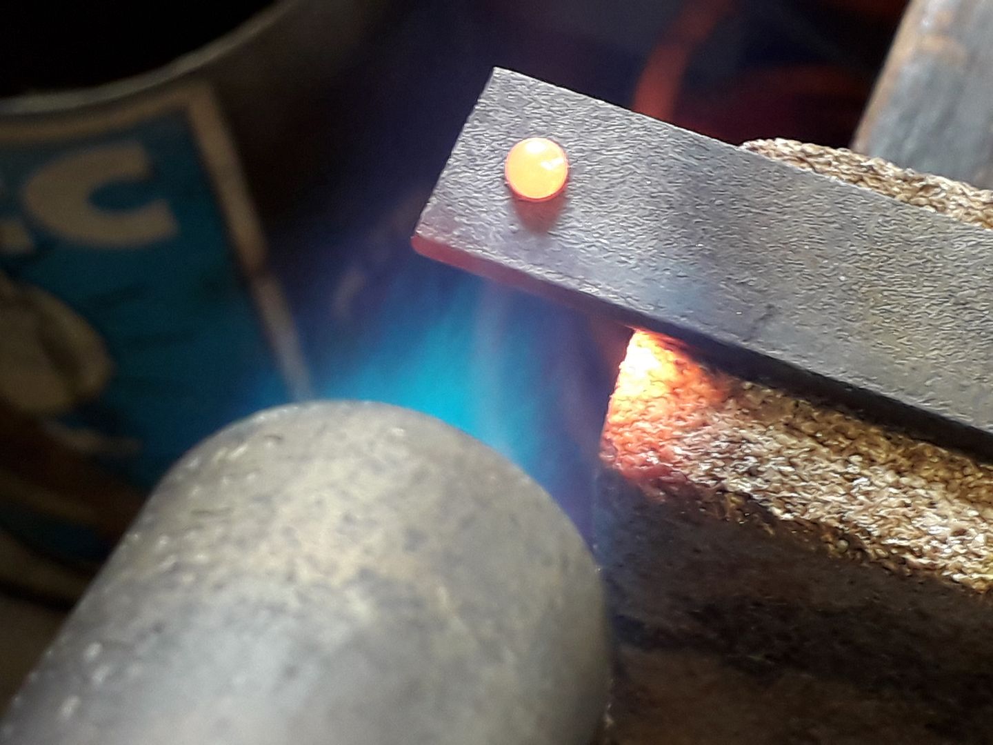

Unless you specifically need a hard ball get a stainless steel one as they can be drilled with HSS, spotting drill usually works for me to get the hole located and form a dimple for the drill bit.
Annealing and rehardening after drilling a steel ball is another option

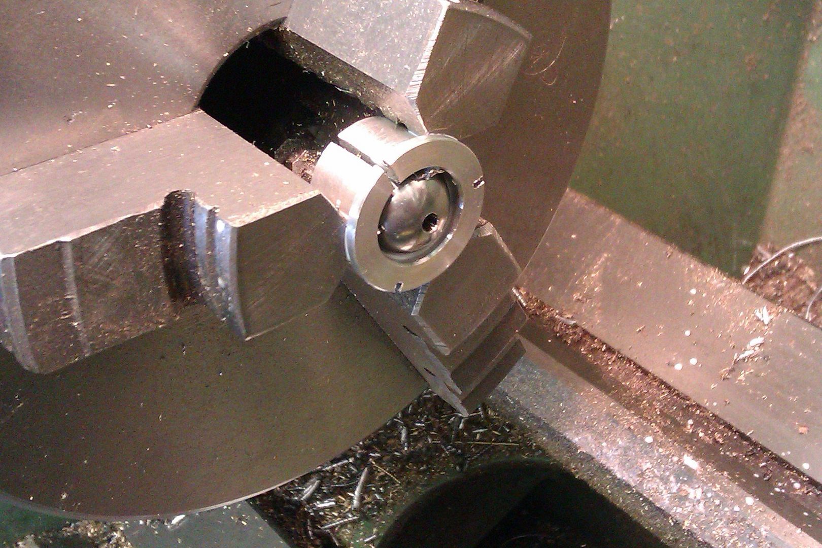

Yes I usually do them in a collet or top hat bush
Small hard one being annealed
After drilling 1.0mm

I had to replace a lost probe point a few years back. Normal inner ball from a std bearing was annealed similar to how Jason suggested; the only difference, it was heated on some dry sand (with a little dishwashing liq) and pushed in with a wooden dowel. Was drilled and tapped using HSS. Any concentricity issues are inherently solved by the small centre drill breaking, but even with a wobbler type probe if you centre it with your finger on the ball all will be good...

Jason, I was back on this one today and decided to try both methods discussed. So I've ordered carbide drills and in the meantime thought I would try annealing some 5mm balls. This didn't go too well. I heated two balls to bright redness and held them in that condition for about 1 or 2 minutes. Then over a similar time period let them cool down. When I tried to drill the first one with my favourite HSS spotting drill it made no impression at all. A quick check under the microscope showed the drill was now blunt and there was hardly a mark on the ball so it simply hadn't softened.
Clearly I need to tweek the annealing process. What should I be doing ?
The other issue is that the balls become quite scaled over from being heated, much more than I expected. Did you have a easy way to remove this scale without too much material loss ?

2 mins isn't long enough for annealing, I believe hot sand has been mentioned as a way of slowing the cooling?
