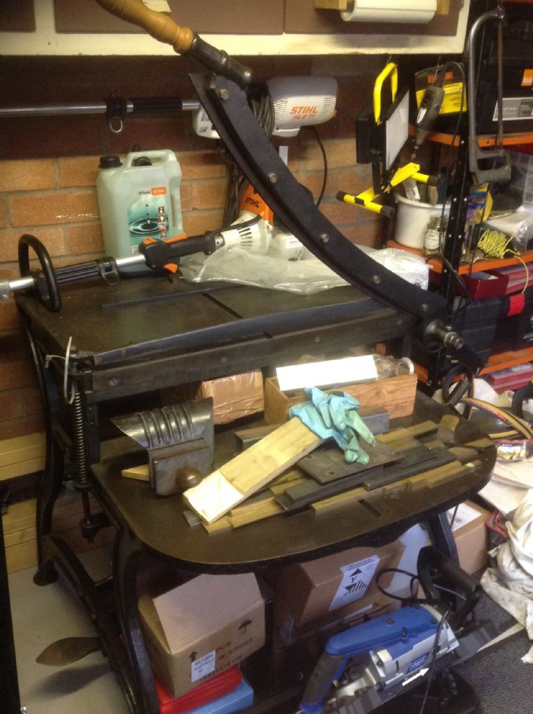

Bill Phinn27/04/2021 19:42:14
1076 forum posts
129 photos
Yes, Swann Morton 10A for card and paper.
I don't use much greyboard these days, but do use the much denser [and archival] millboard.
Since I can't realistically cut either type of board by hand, I use the Victorian boardcutter in the photo for doing so.
Its blade cuts with a shearing action, so thankfully it has a very different profile from the crazily sharp edge a guillotine blade has to have.

@Bill Phinn - out of interest when you cut thin strips of board, does the Victorian Board Cutter (/guillotine?) put a curl into the board that has been cut off to do they recover and lie completely flat after having?
Also where do you get your "mill board" from?

Bill Phinn27/04/2021 23:03:29
1076 forum posts
129 photos
Posted by John Smith 47 on 27/04/2021 20:23:06:
I don't often need to cut narrow/thin strips, but if I do then yes, I would expect a certain amount of curling of the strip, even if the grain direction of the board is parallel, as it ordinarily should be, with the long edge of the piece being cut; if the grain direction is at 90 degrees to the cut, the curling will be much more pronounced.
The curling can, however, be reversed quite effectively if the strip is very lightly damped and placed under a weight between pressing boards until it's completely dry.
One of the best features of the boardcutter, apart from the fact that it will cut through the full width of a 3mm sheet of millboard in one pass, is the foot operated clamp, which guarantees the board will not move while the considerable cutting force of the blade is doing its work.
I buy my millboard [branded Gemini] from John Purcell Paper.
Besides the boardcutter, I also have a fairly old Avery P640 rotary trimmer, which is very useful for paper and card as long as you don't try to cut through too much material at once. If you do, you will not only get a rough finish, but the material will tend to want to move during the cut.
If I was buying one of these kinds of table-top rotary cutters again, I'd probably opt for one of the Rotatrim Professional series of rotary cutters, which I've tried and which seem to be more robust than my Avery.
