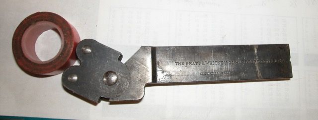

Agree with John that the pins should be considered consumables. Change when you change the wheel.
Surface finish appears to be important. There is a difference in how free running a new wheel is on a new pin when compared to an old one even though there is no easily visible difference in surface quality or wear.
If you plan to make your own push tool may I suggest that you follow the Pratt & Whiney design where the pivot is offset so one wheel is effectively underslung.
My experience is that this style is less likely to mis register producing double knurls. Subjectively it seems to need a bit less force than the common style of pivoting push knurling tool. But that may be due to the push tool in question being hobby bran whilst P&W were a high end maker of machines and tooling.
That said I still consider the "nutcracker" hand squeezed style excellent for casual use. Mostly because set up time is about 30 seconds!

Posted by Clive Foster on 18/04/2021 10:53:24:
If you plan to make your own push tool may I suggest that you follow the Pratt & Whiney design where the pivot is offset …
That’s an interesting arrangement, Clive ... I’ve not seen it before.
