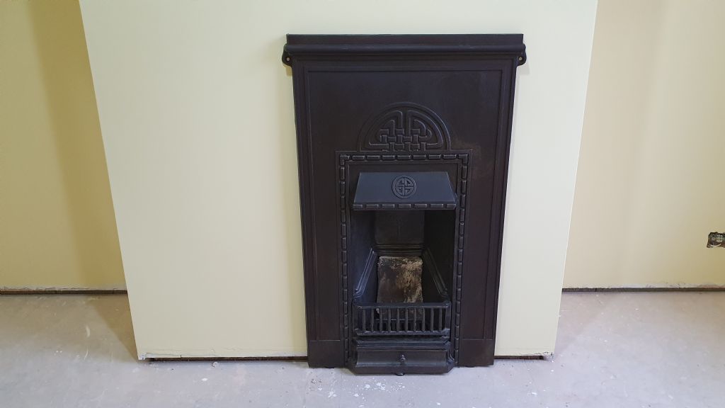

Far from model making but im sure some knowledgeable people on here could advise. Long story short, I have restored a couple of these fireplaces for my house and unfortunately the mantel shelves have been lost to the sands of time and I would like to fabricate some out of mild steel. No problem there however the fireplaces are the bare, raw cast iron dark grey colour/finish and I would like to try and match this for the mantels if possible.
They will obviously be manufactured from mild steel, welded and ground/dressed etc. Just wondered if anyone could offer any advice on how to make them look like an original cast item. Painting is the last resort really, but will paint the mantels if necessary.
Thanks, Craig

Sand blasting might provide a finish you like better?

The texture might be achieved through sand or bead blasting.
The black finish is not as-cast. It's probably a phosphorus dip, (like jenolite) which will turn surface rusting black and give a hard corrosion resistant phosphate finish.
You can simulate this on mild steel by allowing it to rust, wire brushing then treating with a phosphate rust treatment.
Another alternative is a fireplace 'black lead' like Zebrite (which is actually graphite based).

Let it go rusty, then soak it citric acid - which should result in mild steel taking on a grey pitted appearance.

To colour it after adding some texture, you could use cold blackening solution, on items too big to submerge, it actually works very well if brushed on in a flooding type of manner, you'd need to hold it over a plastic tray or something.

As mentioned above steel shotblasting gives a good representation, At one time I worked for someone fabricating replica vintage/ veteran car parts and we had them blasted with steel shot ,it's quite hard to find places that used it, I found a marine company that did it as a favour and a donation to the tea fund. You must carefully mask any threads or bearing seats before blasting, It's a very convincing effect. Normal sandblasting didn't have as convincing an effect, but works for replicating forgings quite nicely.

Thanks all for the tips. I do know someone who does some agricultural sandblasting which might work to blend everything in and give it a bit of texture but that would obviously leave it a light grey.
I had thought of going down the route of submerging them in brine to let them go rusty in order to give them a bit of texture and then treat them to remove the rust. I do believe I have used a rust treatment before that turned the steel black as Neil described.
I do have a needle descaler which i might try out also for some texture.
Finally I could try polishing them with Zebrite and see how that comes out.
