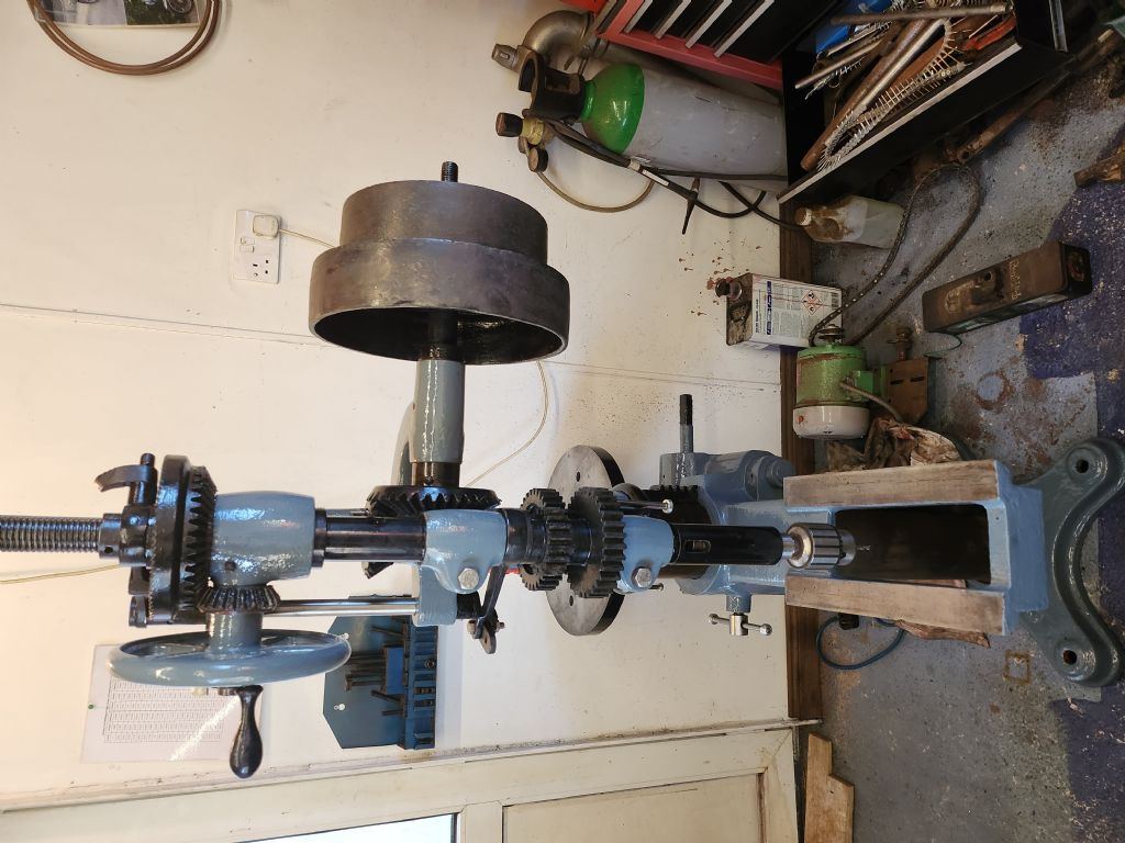

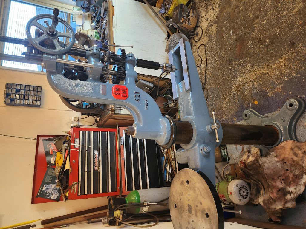

thanks for the compliments lads. nigel, an interesting project you have there. i have a thee phase motor wired up to an inverter but slowing it down to 100rpm would leave me with no torque. the other option would be two sets of pulleys, there are very good pulley calculators on the net which you type in the sizes of pulleys which you have or can get and it tells you the final speed of your set up. i want to keep the flat pulley on the drill and here is what i need. 65mm pulley on the motor 230mm on a countershaft a 70mm flat pulley on the other end of the shaft which will drive the original 280mm flat pulley on the drill! i think this gives a speed of 98 rpm the easiest way to assemble this is bolted to the floor but this means i would have to slip the belt off when changing from using the slip on vice to the round table. there are no ball bearings or bronze bushes on the drill so you are correct about the speeds. there is a very interesting self down feed which i will show when i get it running. it came with two handles one for winding up the table and one for turning the drill! think i would need to eat plenty of porridge to try that carry on.
29/07/2023 16:44:04
finished restoring the old drill and now working out the best way to drive it20230726_194207.jpg20230726_194226.jpg

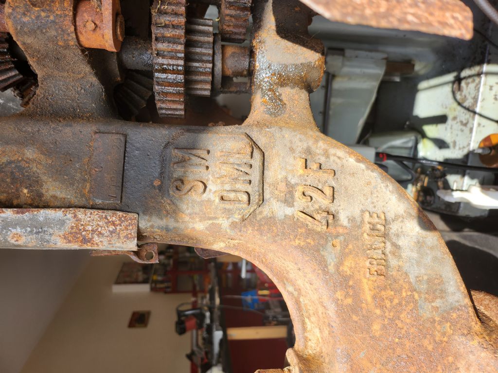

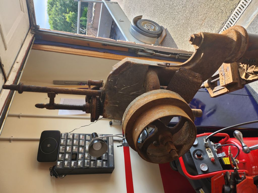

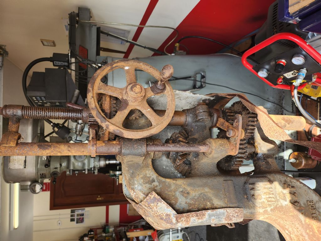

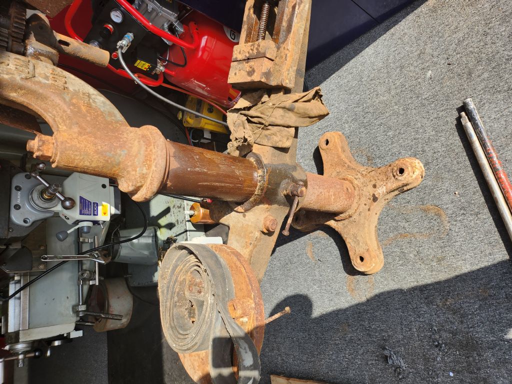

20230623_165502.jpg20230623_165455.jpg20230623_165511.jpggot this old french drill today, does anyone have any information on it20230623_165533.jpg
