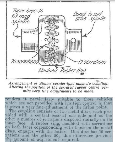

Strictly speaking, a Simms vernier coupling should have round topped teeth, rather like a knuckle thread, but probably gear teeth will suffice, since there should be no relative movement, and the object is to provide a fine angular adjustment.
You will be constrained by the diameter of the original coupling. The number of teeth required on each part may determine the DP that you can use
The space available for the completed coupling will also be a factor in determining the DP
Dimensions of the existing components, if avaliable, should provide some guidance.
The finer the the DP the shallower will be the depth of each tooth, the more teeth will be cut onto the each part of the coupling. A 20 DP tooth will be 0.108" deep, whilst a 40 DP tooth will be 0.054" deep, leaving the space for the body of each part of the coupling.
Presumably, the Driving and Driven parts of the coupling will either have a keyway in the bore, or a tapered bore (Possibly a standard numerical taper? .
The DP will help to choose the depth of the tooth, and so the overall length of the coupling.
Total length of coupling will be: (Overall thickness of Driving part + Overall thickness of Centre coupling + Overall length of Driven part ) This will be determined by the space between the Magneto and the the Timing Case
The counterbores on each of the three pieces will provide space for the nut retaining the Driving and Driven parts to their shafts
The finer the tooth pitch (Diametral Pitch) the finer the adjustment that you will have. and the shorter the length of the complete coupling,
SO, picking numbers out of the air, purely as an example..
The idea is to have one half with,say, 20T and the other with 19T. So that an advance of 18 degrees (1T on the 20T ) is counteracted by retarding the other half by 1T ( to give a retard of 18.947 degree, which effectively retards by 0.947 degrees, when the two parts re engage Or vice versa, to give a fine adjustment.
Since the gear teeth will not be rotating against each other, it would seem allowable to cut the teeth across the face of the components, rather like a flat bevel gear (if you can describe the parts such a thing )
Presumably the technique is to cut three sets of teeth. .In each case the teeth will have to be cut into a face that has been counterbored to a depth, at least, if not slightly deeper than the teeth.
The Driver will have 20T, The Centre coupling will have 20T on one side, and 19T on the other, so may well need to have one set cut whilst on a sacrificial arbor.
The Driven component will of the coupling will have 19T on the face.

My understanding of the construction of the Simms Vernier Coupling is that it comprises of two serrated flanges, with a one serration difference, and a moulded hard rubber disc fitted between them. I assume that the rubber disc is to allow for slight misalignment between the two shafts, it may also cushion the drive depending on the hardness of the rubber. As has been stated, the serrations look similar to the teeth of a knuckle gear and seem to be cast rather than machined.
While machining the metal flanges and serrations, once the shape needed has been determined, would be reasonably straight forward, I think that you will still need to use a moulded rubber centre section to complete the coupling. Using metal for the centre section would result in fretting between the parts as there will be no way of lubricating them.
The link given by Phil P shows all the parts of the coupling, including the rubber disc. You may wish to purchase the rubber disc to get the profile you need. Remember, you could spend a lot of time making a part from scratch when you could purchase parts which only need the bore machining.

Simms couplings are coaxial couplings which take into account a 'slight' misalignment of the two components and also act as a torsional damper for intermittent loading, especially where an intermediate rubber 'sandwich filling' is used. The tooth profiles of these face couplings is not generally of an involute form - more akin to a spline form. The trick in the vernier coupling is the dissimilarity between the numbers of teeth which allows a finite adjustment between the two components to dial in a precise timing. This is achieved by the 'sandwich filling' having differential teeth. It is a more complex arrangement to an Oldham coupling.
For using the dividing head you will need to know the turn ratio and then look for a suitable plate. For instance a 40 turn ratio with a 21 hole plate gives 21 x 40 =840 then say divide by the number of teeth required, say 20 then 840/20 = 42 so you need to advance the plate by 42 holes = 2 turns exact. say you need 28 teeth spacing then 840/28 = 30 so you need to advance the plate by 30 holes, which equals 1 turn and (30 - 21 = 19) 19 holes.

Looking at the pictures provided by Phil's Vintage Car's link, I see the Simms Coupler is made like a Contrate gear, ie the teeth are at a right angle to the face, not around the edge.
Oily Rag explained how Simms Coupler's are adjusted, and here's words and music from 1922! Note the description refers to 'serrations', not gear teeth.
Neither of the pictures show involute teeth of the type produced by an expensive module cutter:

Serrations gripping via a rubber pad suggest the Rotary Table need not be set particularly accurately to cut 19 and 20 serrations on a pair of discs. 360/20 = 18° and 360/19 = 18.94°, which is 19° between friends for a total error of 1.14/360 degrees around the circle.
As the tooth form on the replica Simms spare part looks more like a simple U than the sine shape shown in the 1922 drawing it should be possible to make suitable serrations with a ball-end milling cutter, and to round off the tops with a file. It's not precision work. Otherwise a U-shaped form-tool.
