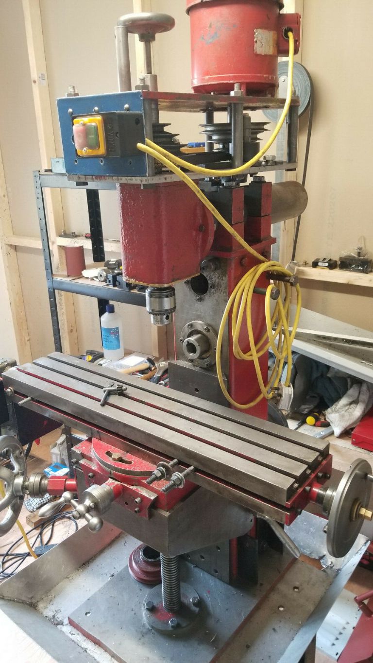

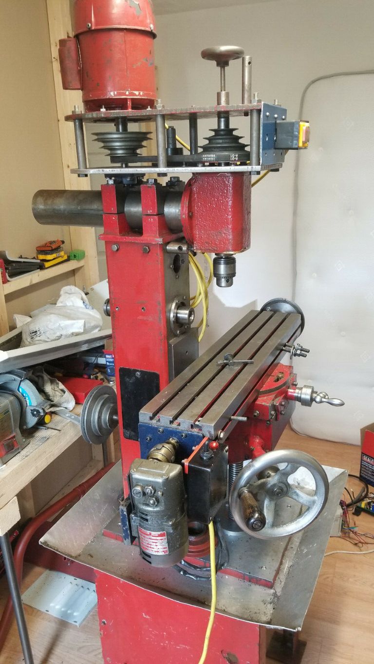

Hello folks, I aquired this milling machine recently which is obviously home built. I am trying to identify as much of it as possible and wondered if anyone could help?

Yes looks 'home made' but a lot of work went to it!

You can have any angle you want, but getting back to dead-square could be a bit of a game... laugh

I saw the wire, and thought: Nice to find someone using ‘safety’ 110V in the workshop
... Then I saw the mains plug crying 2
angel MichaelG.
Aside from that ^^^ it looks like it should be lots of fun.

Isn't it likely to be just "arctic cable" which seems to often come in yellow.
Agree it looks to be a good bit of kit.

You may have to trawl through the milling machine pages at Lathes but there can't be many small horizontals that were universal (table rotates). Looks a bit smaller than a Tom Senior but bigger than a Pools. I think somethign very similar to the base machine was shown fully restored at the ME show about 10 years ago, in the upper gallery at Sandown.

It looks similar to a Sharp in concept.

It may be shop made, but it is still useful universal Milling machine.
With all the angular adjustments a mag base, a DTI and some adaptors are going to be necessary accessories!

Very useful looking machine for milling and gear cutting, did you get the overarm support for the horizontal spindle ?

Perhaps I was a little bit hasty calling it 'home made' It's better than that.
I do have the spindle and support bar for the horizontal mill, all I need to do is wire up a motor and fit a belt, all the pulleys are already there.

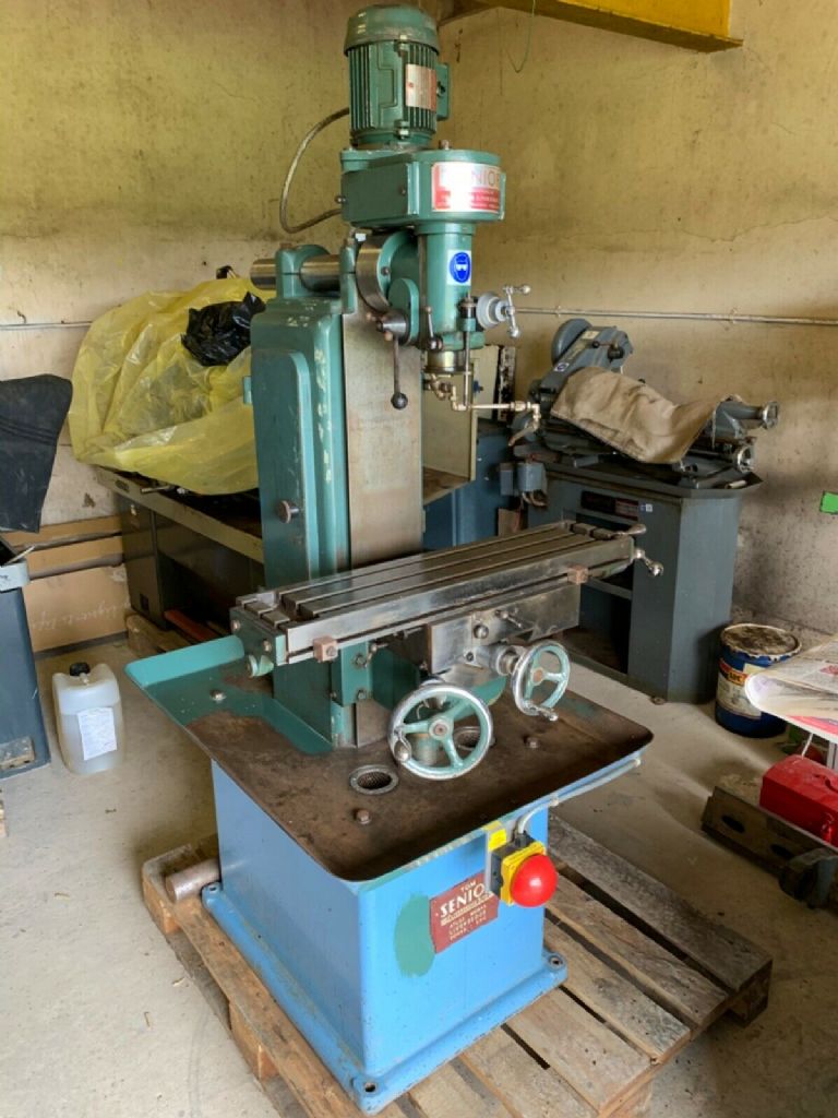

Parts of his Tom Senior on ebay looks almost Identical, I wonder if I could fit a Tom Senior head with a quill

One suggestion I would make for the red mill would be to route all electrical cables with some good cable clips every few inches along the top motor mount / pulley enclosure plate, to the back of the machine. Otherwise at some point you will get one or both cables tangled in work, around the spindle, a broken belt, etc.
You probably already know this but endmills mounted in drill chucks as seen on the pics can work loose and jam. If you don't have some already you would be wise to get some collets for whatever taper sockets are fitted in your spindles. If they are R-8, so much the better compared to Morse taper or others. Twist drills in drill chucks are fine, endmills need proper collets for safe accurate ops.
When the spindle is running be sure and keep hands hair and clothing well away from the handwheel at the top, it is a major hazard when turning.
Looks to be a very handy machine.
