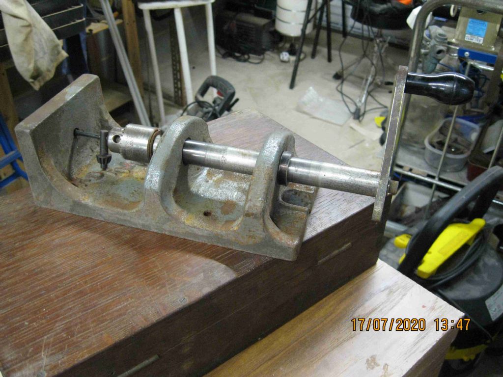

Cornish Jack17/07/2020 14:03:11
1228 forum posts
172 photos
Several years ago I bought a dedicated cast iron tapping jig. I'll try to find it and take a photo. It has never been used for its proper purpose.
rgds
Bill

Cornish Jack17/07/2020 18:17:52
1228 forum posts
172 photos
A hazardous venture into the workshop undergrowth eventually found the hand tapper. It seems to be made by 'ROFMILL' and the photos below showit with the drill chuck key fitted in the tap holder. The handle is adjustable for swing.img_0142a.jpg
rgds
Bill
