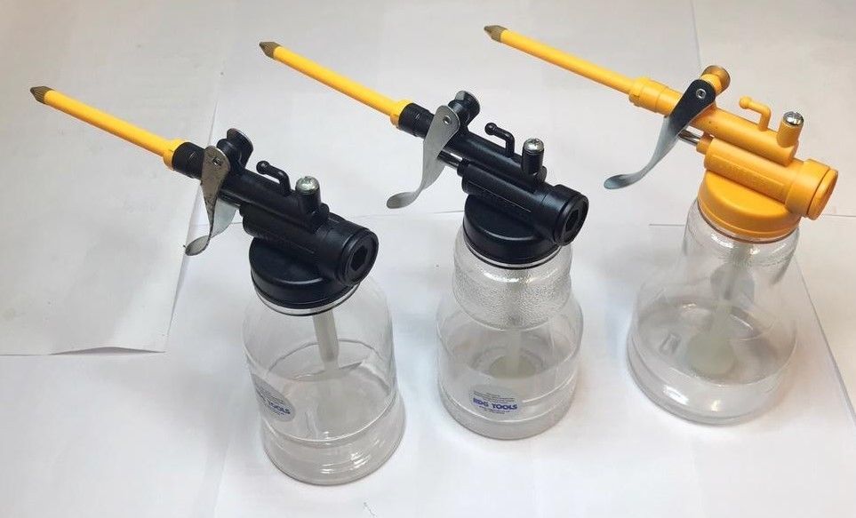

Steve Neighbour27/06/2020 14:21:42
135 forum posts
1 photos
I have a couple of these, no leaks so far wink
The 'nipple' end fits nicely in the bearing type oil points, although you do have to make sure its seated properly or oil sqirts out usually where you don't want it to !!

old mart27/06/2020 17:08:18
4655 forum posts
304 photos
I bought a couple of the type posted by Steve Neighbour, and find them very good, especially with button oilers. They have good pressure. They have had semi synthetic 5W40 and slideway oil in them for nearly a year now and the plastic still seems oil proof. One has a bendy spout.
