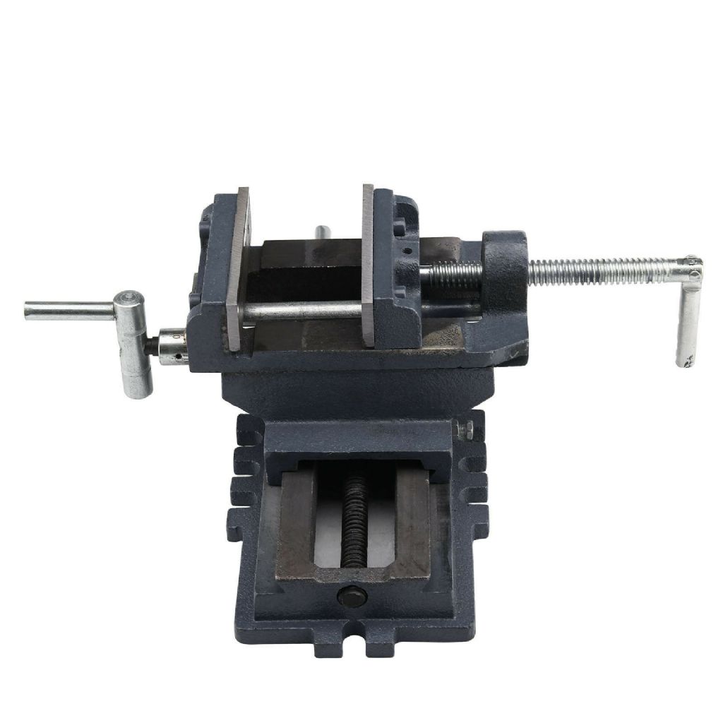

Now I have a mill I’m thinking about sharpening the ends of cutters. I’ve looked at the various kits that are available but they seem to be very expensive and in some ways over complicated so I got to thinking what I needed and what I could cobble together.
An X – Y axis would be good and some method of setting the clearance angles, a smallish (0.25Kw?) 240V single phase electric motor to mount a cup type grinding wheel on and to index the cutter I thought I’d get a couple of Stevensons blocks so I can use my ER32 collects as that covers most sizes I presently have.
I’ve done a bit of ebaying and come up with this for £23.
It may want a bit of fettling on the X – Y axis and I’ll remove the vice part and add a piece of flat plate with a guide for mounting the Stevenson blocks should be easy enough to engineer. It seems a good way to get the basics and won’t break the bank if it doesn’t work. ARC have the Stevensons blocks so next time they have an offer I’ll order them.
The Worden T&C rest seems to have the way forward for the clearance angles so I’ll need to think how they can be incorporated with the X – Y axis device. When I get it I’ll make the decision how to do this.
I can easily fabricate some sort of frame to mount the motor and X-Y table.
Any suggestions for a relatively cheap motor would be appreciated and, of course, constructive comments before I spend any money!
Clive Foster28/01/2020 21:34:24
3630 forum posts
128 photos
Don't even think about a cheap cross vice for X-Y movement. They are very sloppy and the screws far too coarse for a sensible job. The effort involved to get suitably good results is totally disproportionate to the gainProbably too much movement anyway.
I'd be thinking in terms of simple rod, bearing and carrier systems which can be found insanely cheap via E-Bay. This one uses 6 mm diameter rods and is around £20 for 8" / 200 mm lengths.
Loads of similar choices. Even "proper" flat bar and ball bearing carriage systems of adequate strength can be found for about twice the price. That said I'd use something like the Igus range with plain, plastic bearing flat top carriers riding on wider alloy bases which, frankly, is both expensive and overkill. But nicer.

thaiguzzi29/01/2020 03:54:26
avatar
704 forum posts
131 photos
I would stay clear of those Asian cross vise, X-Y tables, you want precise movement in all planes with no shake or wobble.
You want a very fine in feed, an absolute maximum of a thou, and a very coarse cross feed wiping across the wheel, why some T&CG's have a handle rather than a wheel.

Thor 🇳🇴29/01/2020 04:39:18
avatar
1766 forum posts
46 photos
Hi Henry,
I have one of those Asian cross vises, and I agree with Clive, mine too is sloppy and is seldom used. Harold Hall has several pages on Tool & Cutter sharpening, see here, his simple grinding jig is not difficult to make. If you already have ER-32 collets, Stevensons blocks work very well, I use mine often.
Thor
Henry Brown29/01/2020 08:03:01
avatar
618 forum posts
122 photos
Thanks for all your replies! Ok, so I'll ditch the idea of the X - Y vice and have a rethink. I hadn't realised the rod and bearing system was likely to be a cost effective solution so will investigate that further.

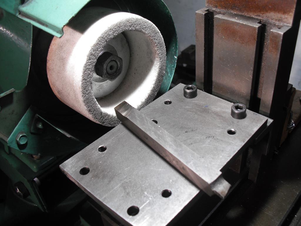

Anthony Knights29/01/2020 21:42:23
681 forum posts
260 photos
Nothing wrong with using a cross vice to get the X-Y movement you require. No point in using expensive precision devices when you're going to spray them with abrasive dust. I have used one for years. I recently removed the vice and fitted a T slotted table which became available when I upgraded my mini mill/drill. I am presently rebuilding the whole grinder assembly.assembled1.jpggrinding rest1.jpggrinding rest2.jpgmilling_cutter.jpgprecision.jpg

Henry Brown30/01/2020 07:49:49
avatar
618 forum posts
122 photos
Posted by Anthony Knights on 29/01/2020 21:42:23:
"Nothing wrong with using a cross vice to get the X-Y movement you require..."
Thanks for posting that Anthony, pretty much what I was thinking!
In the last photo it looks like you are using a lathe top slide I had thought about that after the comments about a fine feed onto the wheel and was thinking about milling a flat to set the Stevensons block on. If I can find a reasonably priced one that will do (lots of Myford ones on the bay) I could drop the X-Y slides and make some form of carrier for bars and bearings as Clive suggested with a chain, sprocket and lever to do the quicker traverse across the wheel.
Still lots of ideas being mulled over...
Clive Foster30/01/2020 11:02:04
3630 forum posts
128 photos
Nice job Anthony.
Your cross vice must be way tighter than mine. Reckon if I tried that something would dig in and wreck the wheel inside 6 months!
I was always told that leadscrew feed for the grinding movement on normal tools was too slow and too lacking in feel to work well. Is this actually an issue in practice or merely a "safest(?)" generalisation.
I've only ever used hand fed systems whether by lever or directly sliding the tool either against a guide or free hand. Hafta say I'm scardy cat with grinding wheels.
