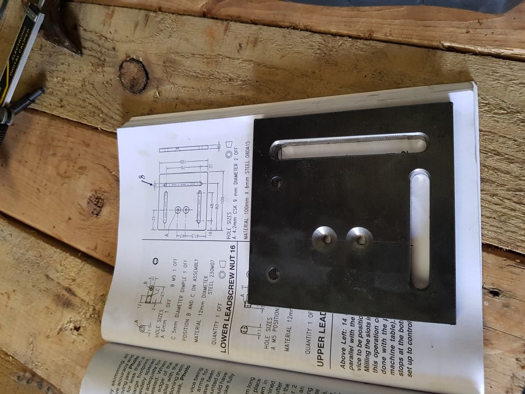

To i made i start on the HH advanced grinding rest. The aim for this project is to learn and improve on my skills. Today's lesson was start at the beginning of the book as the skill gained by making the simpler projects will stand in good stead for the more complex ones. Simple slot milling and setup. The second slot came out a lot nicer the the first one i cut. The print called for a 6mm slot but the smallest mill i had was 8mm so i went with that.

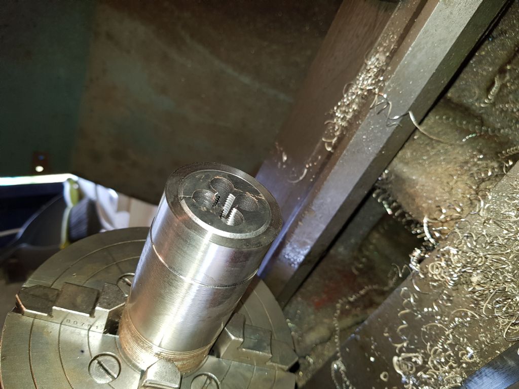

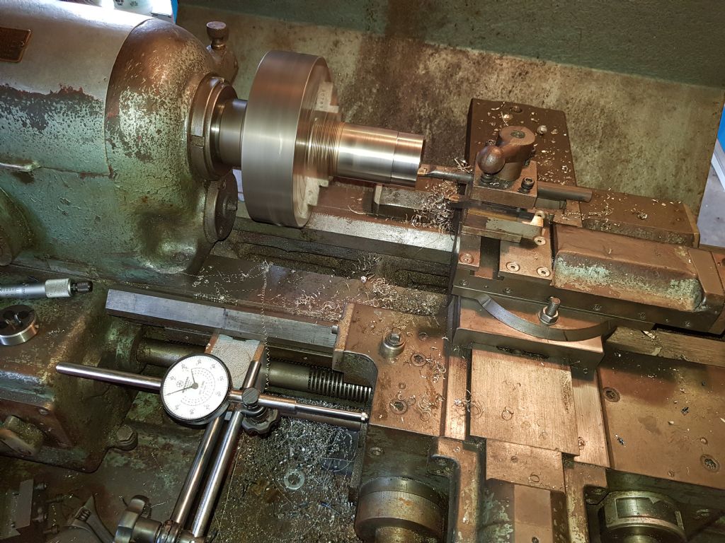

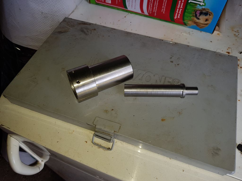

07/06/2020 14:01:33

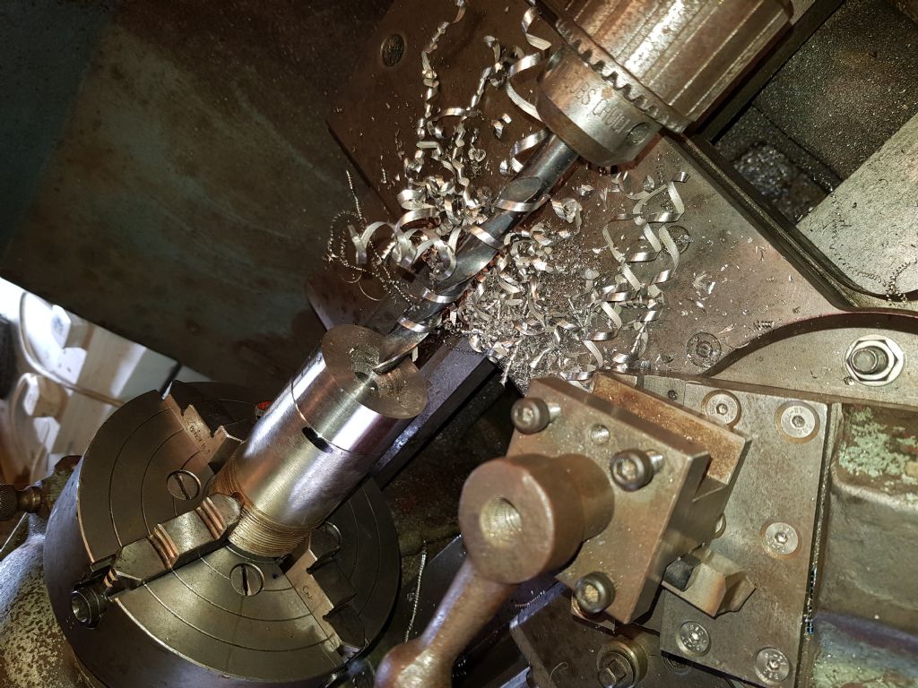

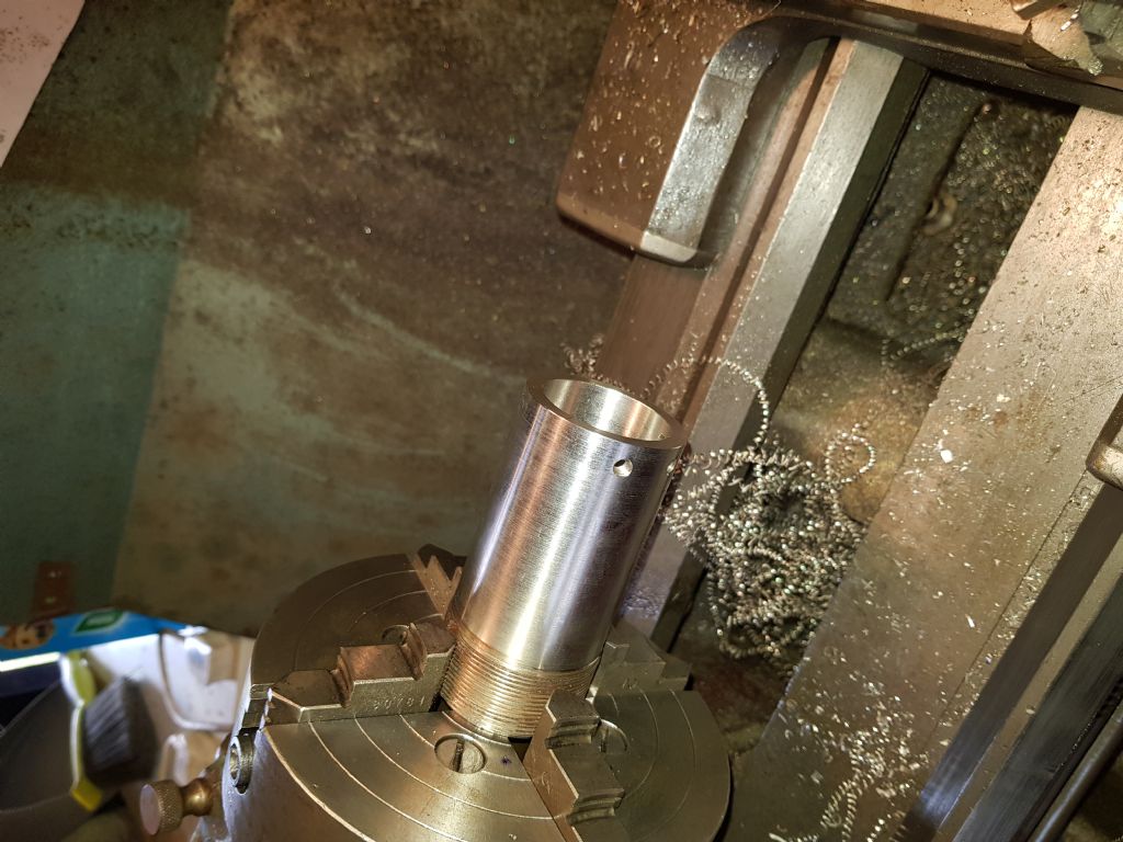

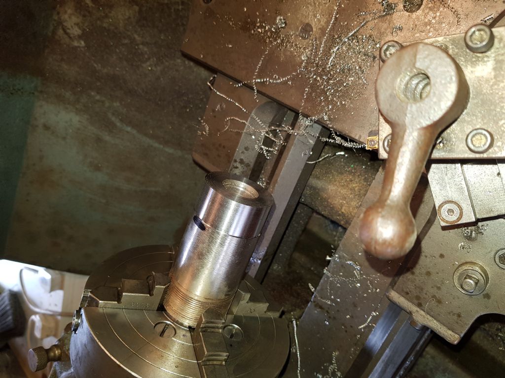

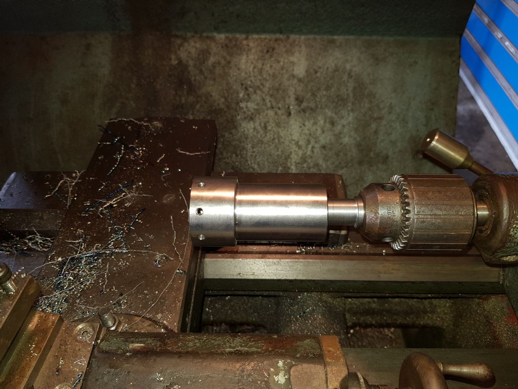

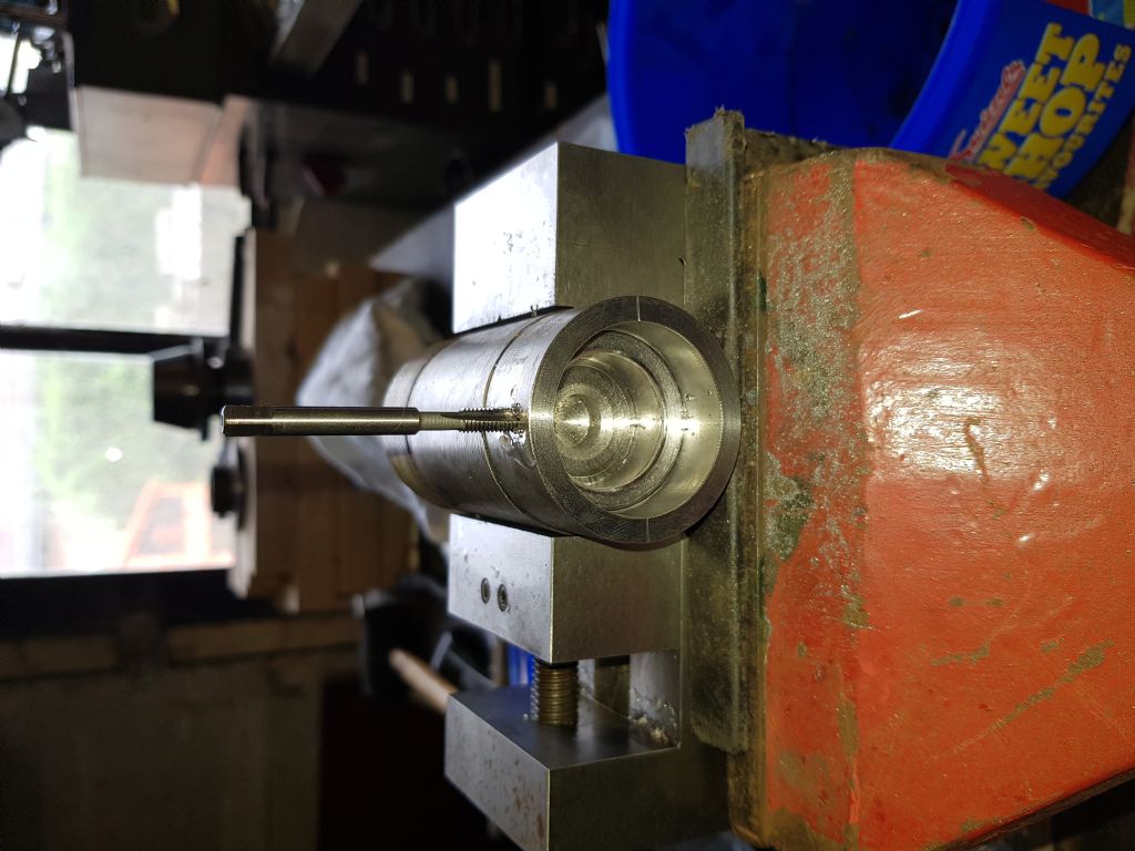

After posting a question about cutting a m10 thread, some of you suggested macking a tail stock die holder.
So here goes.
This project was born from needing a tool to make a tool. As is so often in the home workshop.
Anyway i was making a toolpost mount and needed to cut a m10 thread. Didn't have a die so i orded one. When i came the OD was 1.5 inches. Didn't have a die holder big enough. Order one no no make one. So i started to make one out of god knows what HARD HARD steel i had. As i was in no rush and not having used the 4 jaw cuck i dug it out and after 10 minutes faffing about got in running within about half a thau. Good enough for me. Some pictures
Started out by turning the OD to what seemed to be a decent size to accommodate to handles.
Drilled and bored out the the ID to a perfect fit.
Using the DTI to get to the correct depth.
In this picture the die isn't pushed all the way in. When it is its perfectly flush.
Then marked out, drilled and tapped the 3 securing / adjusting screw holes.
The plan was to cut it off the length, drill and tap 2 holes 180 from each othe and add handles. Job done.
Well not so. After taking advice from forum members its back in the 4 jaw running true and ill drill and bore through the middle and turn it in to a tail stock die holder.
Is my skills are at the beginer level im not going to make a mores taper arber. My plan is to bore the through hole 1 or 2 thou over the OD of my tail stock and use the extended tail stock as the running arber if that make sense.
More progress pictures to follow when i get back in the work shop. Hope you enjoyed read the exploits of a beginner and any advice more than welcome.
