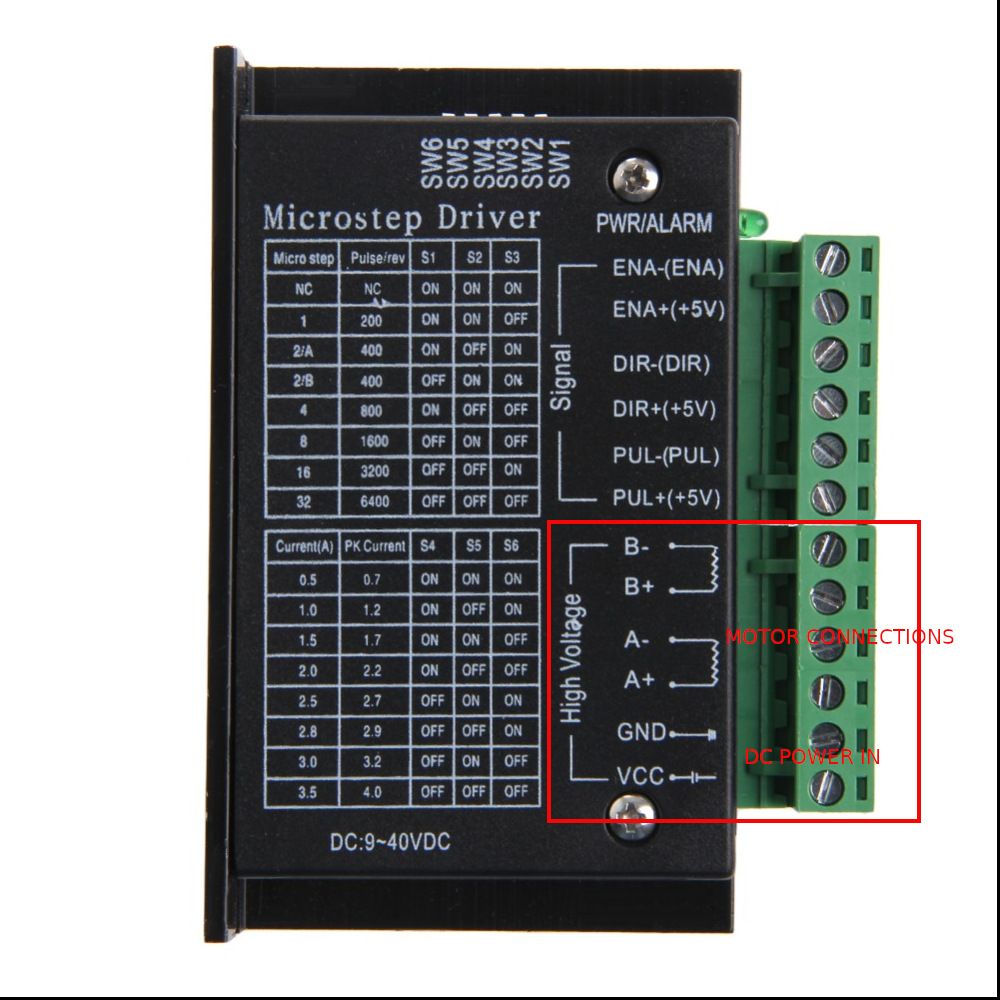

SillyOldDuffer15/02/2019 11:54:24
10668 forum posts
2415 photos
Posted by ChrisH on 14/02/2019 19:44:40:
Electronics is one avenue I haven't been down for 40 + years, so stepper motors and their electronic control has passed me by. However, I now see a need to know some more about that latter subject as I can see an opportunity to employ a stepper motor drive.
I have been looking on the internet for information on stepper motor control but either what I have seen asks more questions than it answers or, more usually, the authors seem to be writing in another language!
So, can anybody suggest an idiots guide to stepper motor control, along the lines of "idiot to expert in no time at all", written in plain English to be readily understandable to someone without a degree in electronics and electronic control and a lifetime's experience in the subject. And I mean idiot!
All suggestions will be gratefully appreciated! Thank you.
Chris
Edited By ChrisH on 14/02/2019 19:46:22
Do you want to understand how they work, or just enough to use them? The former is difficult, the second a good deal easier. The same is true of most types of electric motor - not many on the forum could give you a detailed explanation of how AC motors actually work. Much more common is people who've learned enough to wire them up. I know this because I'm one of them.
A basic stepper motor has two windings. The motor isn't fed ordinary DC or ordinary AC. It works by applying particular sequences of DC pulses to both windings.
The motor doesn't turn smoothly, it steps. It can do one of three things per pulse-combination;
  • step one notch forward, or
  • one notch backwards, or
  • lock in the current position.
The number of pulses needed to make a single revolution vary, but 200 steps is common. However, another feature is that by manipulating the pulses fed to the motor, it is possible to move and hold the motor in small steps between the natural steps. A 200 step motor can be manipulated to take up to 6400 micro-steps per revolution.
The motors have good turning power and the spindle can be moved fairly accurately to any angular position. RPM is rather low compared with other motors.
It is not necessary for the user to understand the nature of the pulses, or how they are generated. This is done with a box full of rather complicated electronics like this:
End of Part One
Edited By SillyOldDuffer on 15/02/2019 11:56:04
SillyOldDuffer15/02/2019 11:55:14
10668 forum posts
2415 photos
Part Two:
Although intimidating at first sight, taken one at a time, the controller is rather simple to use. The DC Power Input and motor are connected here, in the red box:
This particular controller works with between 9 and 40V. Check your motor's specifications for it's upper limit but generally stepper motors will run 'better' fed a high voltage rather than a low one. But they work across a wide voltage range - it's the current that matters. For the same reason it's 'better' to use a crude unregulated DC power supply than a fancy regulated unit; regulated power supplies tend not to perform well driving pulsed loads. However, I didn't understand that when I built my rotary table and it works perfectly well with a cheap 12vdc regulated LED power supply.
If you whack a lot of volts into the motor there's a risk of of heating it due to exceeding its power limit (again see spec for the maximum current a particular motor will take.). To avoid damage the controller provides switches (marked SW1 to SW6) that can be set to limit the maximum current delivered to the motor. Given an unknown motor, you can start with the lowest setting and move up the range until the motor works properly, ie turns without losing steps.
The number of micro-steps needed for the motor to do a full revolution motor is set in the same way. The ends of the switches can just be seen in the red box at top of photo. The number of micro-steps is a compromise that depends on the application. Generally it is set to the lowest number of steps needed to achieve the required step accuracy. No point in simply going for the maximum number of steps, because there is no such thing as a free lunch. At high micro-step settings the motor is more likely to lose steps under load and the rpm is lower.
Finally the control connections. These occur in pairs working in the opposite sense to suit the electronics used to control the controller.  By convention these can either signal 'ON' by putting 5V on a connection, or signal ON by grounding a connection that has 5V on it already.
ENA is enable. The controller won't power the motor unless this is ON.
DIR is direction. When ON, pulses are generated to turn the motor clockwise, when OFF the motor turns anticlockwise.
PUL is Pulse aka Step. Each pulse applied to this input moves the motor one micro-step.
ENA and DIR can both be set with ordinary on/off switches but PUL requires a stream of pulses. These could be generated with a simple chip like the NE555 and a speed pot.  More likely something sophisticated like an Arduino or PIC micro-controller would be used. They can be programmed with whatever the user wants to do. For example, an Arduino could calculate the number of pulses needed to rotate the motor by an angle input by the user, then enable the motor, set direction, issue the right number of step pulses, and then dis-enable the motor. By keeping count of pulses and direction changes the micro-controller always knows where the motor is. A more sophisticated controller could translate G-Code to drive several stepper motors on a CNC machine. Controllers can be bought ready made in various shades of complexity.
What could possibly go wrong is another question!

ChrisH16/02/2019 14:19:24
1023 forum posts
30 photos
Jason - I await MEW 279 dropping through the letter box!
Dave (S O D) - many thanks for your last two posts - the explanations and photos were both illuminating and informative.
You are quite correct in splitting the knowledge requirement into either understanding how they work or how to make it work; I'm firmly with you in the second camp. What I really need to to know is: what bits do I need, how do I connect them all together, and how do I get it to do what I want it to do in each specific application.
