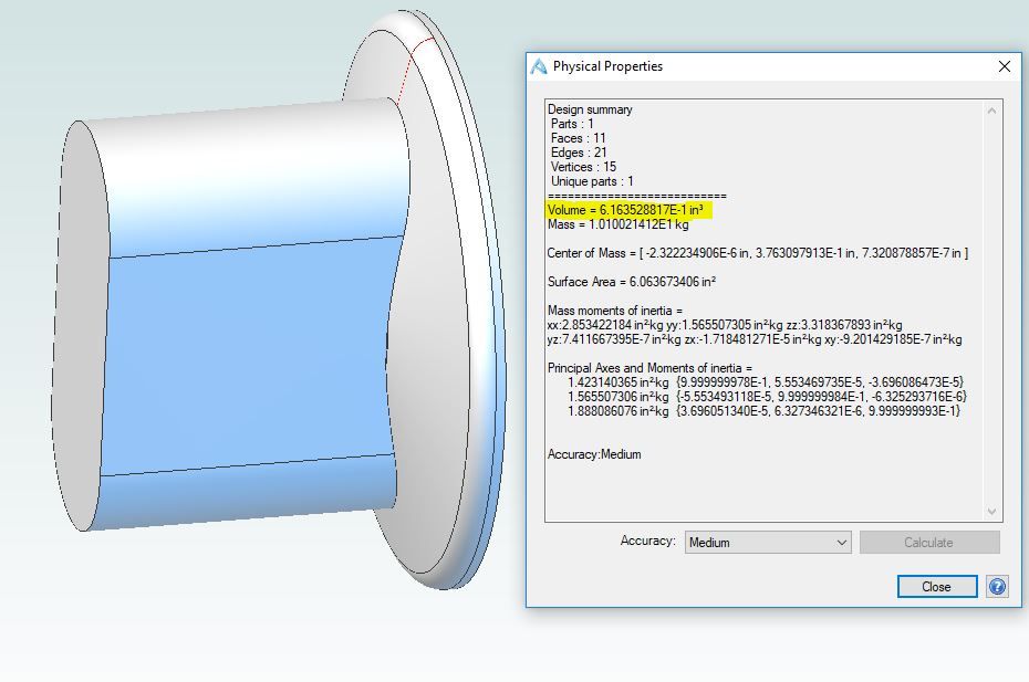

JasonB04/02/2019 08:24:53
avatar
25215 forum posts
3105 photos
1 articles
I just had a quick look at the Centaur drawings and looks like the compression ratio works out at about 4.5:1.
Bit of guess work on the head cavity which I came up with 0.64cu.in for. Piston stops 1/4" from the head so at 1.5" bore that s 0.44 cu. in giving a total of 1.02cu.in.
With 2" stroke the swept volume is 3.53cu.in
Therefore total volume 4.55 : unswept 1.02
Edited By JasonB on 04/02/2019 08:27:46
AJW04/02/2019 12:57:21
avatar
388 forum posts
137 photos
Thanks Jason!, This morning I used a pipette to measure the combustion chamber volume.
The chamber is at present completely unmachined although I have the spark plug hole drilled it was taped off.
Volume measured 8cc so with a swept volume of 57.8cc it works out to 7.2:1
I shall mill out the deep part of the chamber (up to plug) although I don't believe there is much to come out, more of a clean up operation. I will then bore out for the valves, which should end up fairly flush with the inner surfaces. I will then measure again, after which the shallow tapered part of the chamber will be the only part which could be machined to lower the ratio.
Do you think I ought to aim for something like 5:1? as this is a one way journey!
Alan
JasonB04/02/2019 13:07:37
avatar
25215 forum posts
3105 photos
1 articles
Alan, have you allowed for the fact that the piston crown should stop 1/4" from the head?
