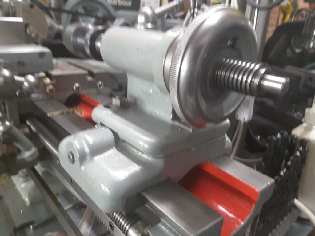

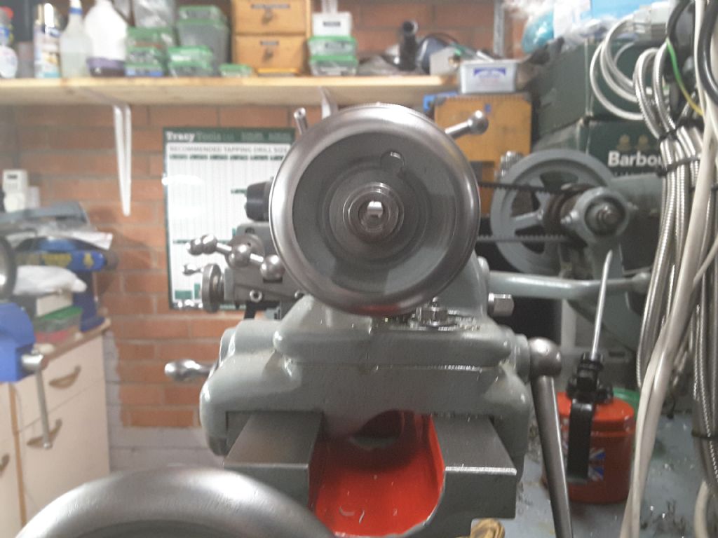

So I have a Drummond and have stripped out the tailstock the downside is that it has a Drill chuck seized in it and alas does not have a facility to use a drawbar. I have tried heat, cold. penetrating oils all to no avail. Has anyone got any ideas?
My next will be soak in derv over the weekend.

I would make a couple of spacers to go between the tailstock body and the back of the chuck and then use the feedscrew and handwheel to try and push the chuck out.

Roger, Thanks for this but I tried that in the very first instance and nothing it just locks up. I suppose I could put stilsons on the hand wheel but think that's a tad brutish for such an old lady.

OK. Another option (which was done on my brother's slightly later version of the same lathe) is to drill through the quill from the handwheel end which allows the use of a 'knocking out' bar.

I did start the idea of drilling through but can you remember how deep it was before you broke through with your brothers machine ? I think I drilled about 1/4" but still solid ?

This is going back a long time but I think it was quite deep, 25-30mm. If you have a MT1 something with a tang on it it will give you an idea of how deep the taper in the quill is.

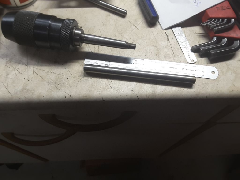

Hi Ian on my M type I have a 3/8 clearance hole through the rear and I use a piece of silver steel to drift out the Morse taper. If you were to drill the reverse with a drill it should come to the point where the tang is and you could drift it out with a bar. Look at the pictures in my new album M type tailstock.
You can see though spindle and drift is about 5 inch deep to end of taper part.
David

Eureka1 tap with the ball joint splitter and it came apart BUT yes there always is the depth of the hole is only 2 1/2 inches deep so need to drill right through. Anyone near Chatham able to assist me ??
