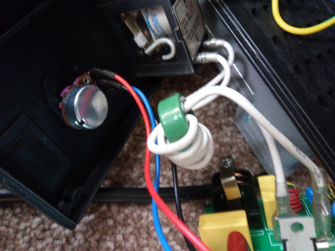

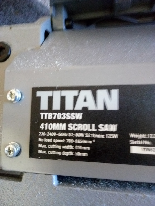

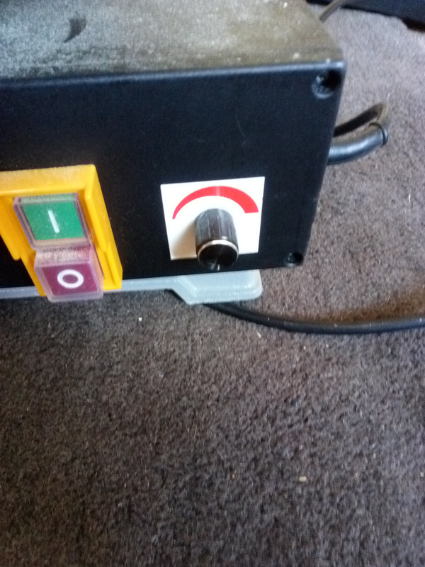

right this is it.
pic of dial and plate on side.
when it speeds up almost shakes it self to death.
john fletcher 129/06/2018 17:52:09
893 forum posts
Having seen the picture I think Neil is correct. If you unplug the saw, then open up the box with the knob on the front and you will see what looks like a volume control and on the back of it (if you are lucky) will be its value in Ohms. For example 10K Lin. You can buy a replacement from several suppliers on line RS, Farnell, Rapid or ESR., it must be a Linear type (Lin ) Or, if you know of an electronic repairer a quirt with their RS switch cleaner might solve your problem. John

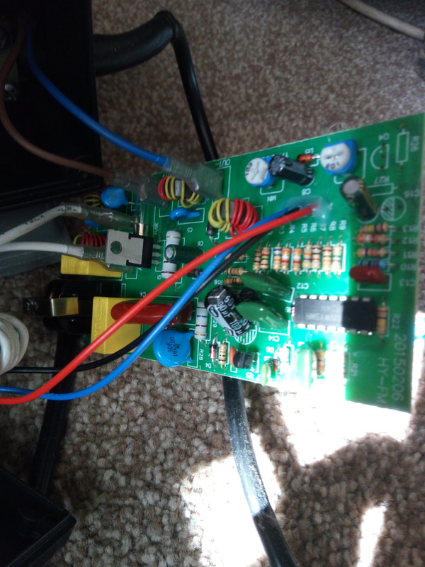

nothing on back of controller
couple of pics if any use.
it starts of slow then speeds up and slows down and sppeds up at random.

I think it is unlikely to be the pot (potentiometer) but if you want to test it...
The speed pot has 3 connections. Disconnect the middle connection (black) and connect it to one of the other pot terminals (also connected to red wire) and run it - you should get either max or min speed depending on which end.
Then do the same but connect to the other pot terminal (also connected to blue wire) and run it again.
Leave red and blue connected to the pot at all times.
This will give you max and minimum speeds. If still not stable in speed it is 99.9% certain not the pot. If it is stable then change the pot - the value is written on it and plenty on ebay.

I see one of the preset pots on the circuit board is marked 'min'. I guess the other is marked 'max'.
Bearing in mind that board has mains on it, experimenting with careful adjustment when the thing is unplugged should enable you to set sensible top and bottom speeds.
Beware of setting the slowest speed too slow, or it will overheat.
SillyOldDuffer30/06/2018 17:55:23
10668 forum posts
2415 photos
Misbehaviour when the board is vibrated suggests a loose connection or bad joint. For example an intermittent on the either of the max or min pots would cause the control range to float and confuse the poor thing.
Try flipping the board over and checking with a magnifying glass for dry joints, cracks between joints and board or components and - less likely - tiny whiskers of solder bridging any connections. This link has a good overview.

mick7030/06/2018 18:22:38
524 forum posts
38 photos
Posted by Neil Wyatt on 30/06/2018 17:23:05:
cheers i set them so both same and runs lovely.
min was turned out two turns max only one.
set both to one turn.
