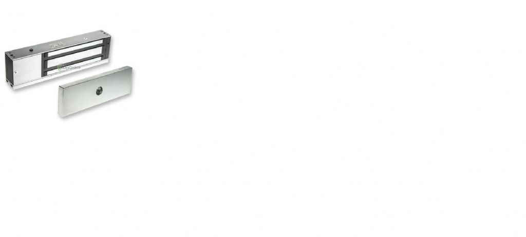

Just thinking aloud, would it be a good idea to convert a door maglock for use as a magnetic milling vice?
**LINK**
I have seen some maglocks with holding power of about 500kg, for thin or irregular shaped work pieces should be more than enough clamping force... To be honest I'm tempted but before doing something silly I would appreciate your thoughts wink

The lifting power of Bux lifting magnets is very dependant on the thickness of the material it is being used to lift. Thin materials reduce the load that can be lifted. I suspect a door maglock may have similar issues. This is why magnetic tables for machine tools are usually multi-pole. Is the maglock multi-pole? What is the plate used with maglocks like?

From a sufficient number of years of toolroom experience with surface grinders, both chucks with either permanent magnets or DC electromagnetic, I would expect that the rapid, intermittent cutting forces from millng tools, could slowly dislodge/move a work-piece out of alignment. Clearly, this would require some positive means to stop this in the X and Y directions.
I would also suggest that you'll need a de-magnetiser, to reduce the annoyance of (carbon steel) work-pieces remaining magnetic. On that score too would be the collection (and removal) of swarf around the 'vice'.
Using a dial indicator for 'clocking up' near such a vice is also likely to introduce issue with immediate/residual magnetism.
I'm sure this thread will attract other views.

You will also find that it disrupts the action of a wobbler when trying to find an edge. And the wobbler, being made of carbon steel, will get magnetised and need demagging if ever to work properly again.

I think it's a single pole DC electromagnet magnet, the plate is 16mm thick and on that plate it gives a hold down force of 550kg.
It also depends what machining operation is being carried out I think, say, you will not use it to hold a workpiece you're flycutting, but maybe if using a small endmill the forces would be lower?

I have not seen a commercial mag vice for a mill (not that there isnt one because I haven't seen one). I suspect that the holding power is not enough for general milling but there may be very specific circumstances where a light cut on some jobs would be OK . They seem to be ok for surface grinding but the forces involved are very different. You would be limited to steel so all the other materials we use would need conventional holding systems that are also good for steel. A scenario I imagine a mag chuck would work would be CNC engraving on a plate of a reasonable thickness and size.

Surface grinders are one thing and milling machines are another. Holding force quoted will be the maximum rating - thick, flat and over the whole magnet area - and not brass, aluminium or even most stainless steels. Seems a limited piece of kit to me, even in its optimal form, without trying something not designed for that use.
