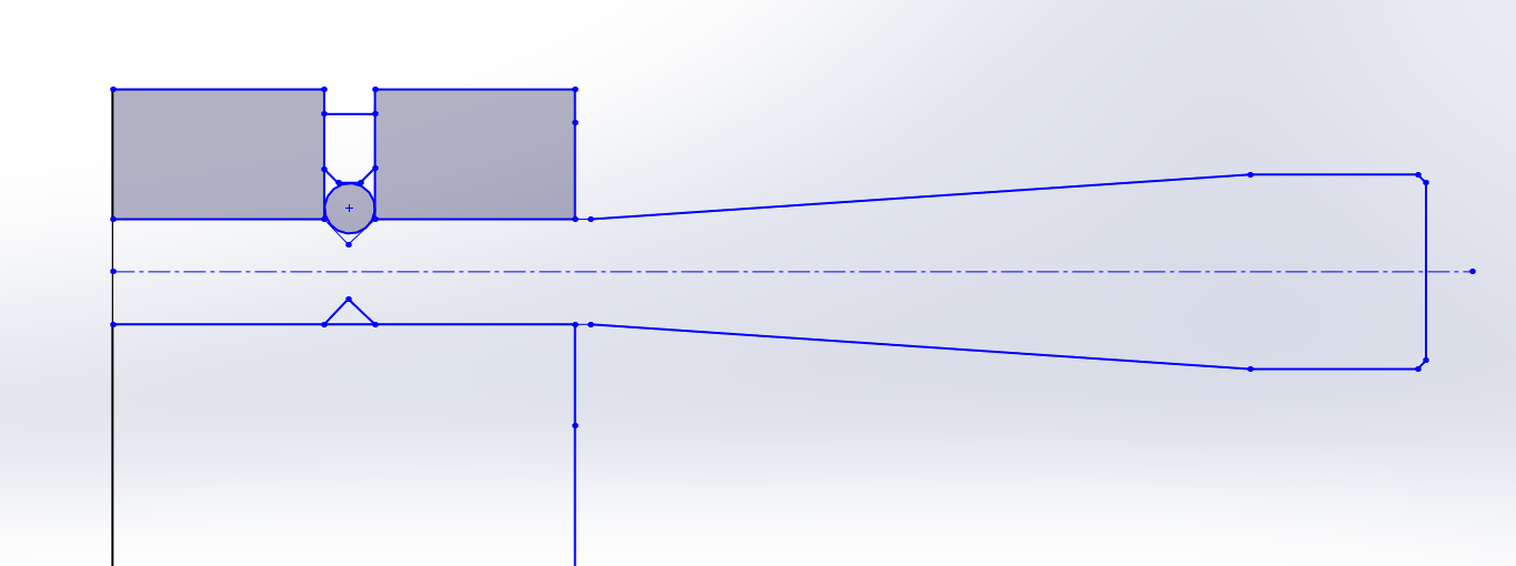

Anyone have a method for making cranks for handwheel that rotate in your hand as you turn them?
I have a concept where the handle is a tube running over a shoulder bolt but that gives a fairly large minimum diameter and I have to match the length nicely or it would have axial play (not really a practical issue but it would feel more amateurish to use).
Off the shelf I can buy them for about £5 upwards but why spend £5 when I can spend £4.50 and 3 hours of my time building one?

I usually make starting handles for the hit and miss engines using a cap head bolt as the spindle. handle is drilled a nice running fit on the plain shank of the bolt and counter bored to take the head. No need for a shoulder bolt if you make the length of the through hole just less that the distance between end of thread and under the head. Screw bolt in until it runs out of thread and there is still a little lengthways play so the handle does not get locked up tight.

Ooh that makes things a fair bit cheaper
My other concept which I'm sure I didn't invent was having a ball bearing retain it axially
Down side of course being I have to cross drill and tap the handle. Allows for thinner grips but needs thicker handles
