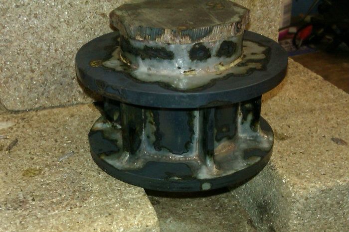

Hi all, I need some advice. I have just finished brazing the steps and brackets for my Pansy 57XX loco and i need to clean up the carbon residue following the brazing. I have used a wire brush as far as possible but can't get into the corners. I am thinking about pickling them but not keen on using strong acids. I'm sure I have seen something mentioned in the past about using ordinary household products. I know that Cola can clean copper based items and possibly white vinegar or lemon juice. Can anybody suggest a method.
Thanks, Alan.

Hi Keith, thanks for your input and I can confirm is it is not The Cup Alloys purchased flux. The brazed joint is one side of the bracket. The whole bracket is discolored black and also has sooty deposits. I did use a wire brush on the accessible parts of the brackets but it is the corners of the steps I can't get at to clean before painting.
Alan.
JasonB26/02/2018 15:23:48
avatar
25215 forum posts
3105 photos
1 articles
Keith, I suspect Alan is talking about steel fabrications not the copper boiler. I also find that the steel takes on a black coating on the areas that are not fluxed but being happy to use an acid can get it to come off easily together with the HT5 flux.
This is the sort of black being talked about
Edited By JasonB on 26/02/2018 15:24:19
