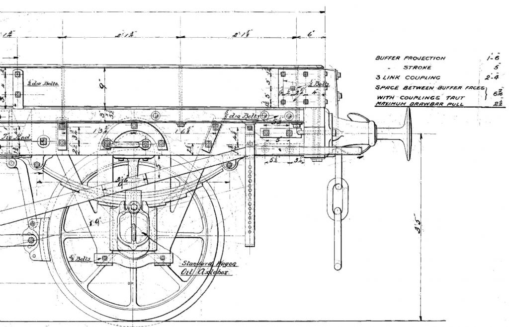

For some historic models I need about 400 Square Nuts, Steel, with 4 mm Spannersize and 3 mm Height in 8BA or M2. These do ot seem to be available anywhere, or are they?
If I'll have to bite the bullet and make these myself (have a Myford S7, but not a Pultra Lathe, though)), what would be a clever method to produce alle these nuts?
