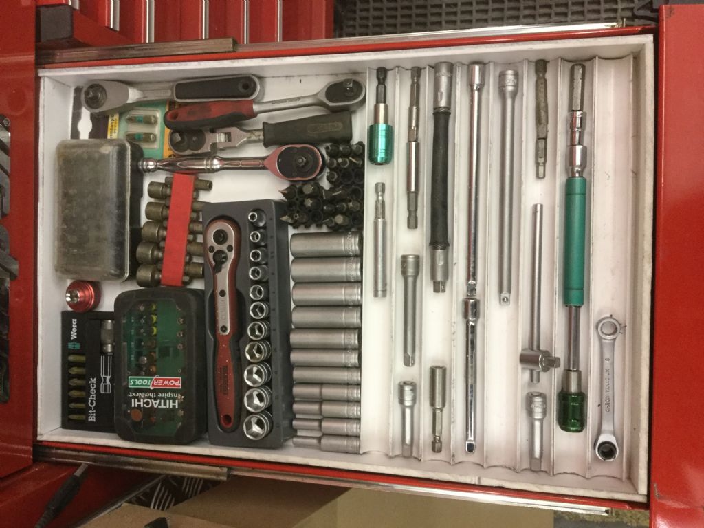

Something iv’e been contemplating too, so will be interested to see peoples solutions.
This is an unfinished prototype made from Solvent weld overflow pipe and foamex board, glued together with superglue.
It works, but is quite labour intensive.646e612f-a863-49e8-8ac2-b57bf0dcd8a7.jpeg

Piece of 4mm ply cut to fit draw with some strips of MDF glued to it works for me.

Carpet underlay is quite good - soft neoprene type material and has ribs to stop things rolling around too much. I’ve also made up liners similar to those Jason has pictured - 6mm mdf bases with narrow mdf strips glued on. Dies can be sorted with another bit of 6mm mdf with suitable holes drilled.
Another possibility is polyurethane expanded foam sheet (Styrofoam) - it would be very easy to run some u shaped grooves in it to hold taps, milling cutters etc.
