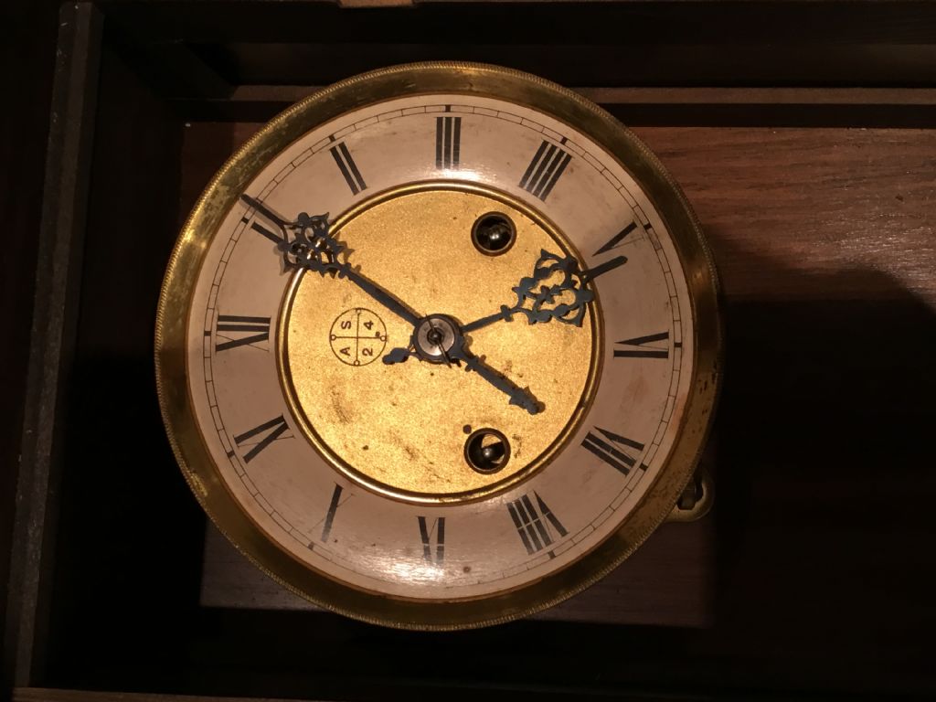

I recently ‘re-discovered’ a clock in my loft that I had been given by my father many years ago. I know nothing about it apart from the fact that it hasn’t run for probably 30 years or so. I’d like to get it going properly again (currently it goes for a couple of minutes before coming to a halt) but having no practical experience of clock maintenance or repair, I’m going to need a lot of help.
I have many questions but to start with :-
Can anybody identify it from the photo? There is a pediment to the case which has been broken off, as well as a lower equivalent. I’m assuming it’s mass produced but even a rough date/age would be nice.
How is the movement held in the case? There are 4 screws holding the backplate to the case, two of which are accessible but the other two are not. There are 2 knurled ‘thumbscrews’ (not sure that’s the right term) at the lower edge of the face which when loosened allow the movement to pivot backwards slightly. I haven’t undone them totally yet but am I right in assuming that is the way it’s done?
Both the outer white ring & the inner part of the face, which seems to have a sort of ‘sparkle’ finish, are quite tarnished. How easy would it be to clean these?
Any advice / helpful words would be much appreciated.

Your clock should be OK but probably in need of a strip-down and clean. It is of a quite common type.
As for cleaning the face, be very cautious. I'd suggest you try some cotton buds and saliva ! It can be surprisingly effective. Certainly don't use any proprietary metal polishes.

The clock was made in germany mid to late 19th c .the two knurled screws will release the movement from the backplate.Their production declined after the american mass produced clocks flooded the market.They were often refered to as regulators which they are not.

At first glance it ooks like a Vienna regulatoror Vienna wall clock as far as I can see. Should have 2 weights. Many of them had Eagles on the top of the case when new but most of these were removed when the war broke out for obvious reasons and were subsequently lost. However it is somewhat 'crude' as there is no seconds dial, degree plate on in back panel for the pendulum and the case looks a little plain. It's still a nice clock though.
Have a google for Vienna regulator for more information.
As far as initial running attemps. as has already been suggested clock oil the oil sinks at the ends of the wheel arbors and adjustment of the beat achieved by moving the crutch (the lever between the escapement and the pendulum rod) so that the beat is even will probably bring it to life.

Brian When you get the movement out of the case. Please make sure that the movement is not wound up before doing anything else.
Perhaps that needs a little explanation. If you start to dismantle it with the springs wound the not inconsiderable energy stored in the springs will be released suddenly and may cause damage to parts of the clock as well as to your fingers.
To release that energy in a controlled manner you need to get at the ratchet pawls. Best to remove the dial but first you will need to remove the hands. They are fixed in place by a clock pin (a small taper pin) in the centre. Remove that and both hands should pull off. The dial will probably be held to the front plate by three or four pillars with either nuts or pins.
Having removed the dial you should see a ratchet wheel on each winder. You will have to use the winding key to hold the spring force to enable you to move the pawl back and release the ratchet. Don't let go of the key but allow it to rotate backwards while controlling it. You can do it a bit at a time allowing the pawl to return to hold it while repositioning your hands. You will find it much easier if you have three hands!
Once the springs are unwound fully you can think about dismantling and cleaning.

If you find you've opened Pandora's Box by asking for advice ~ then since you state the clock will run for a couple of minutes then stop, it's possible that "non-clock" oil was once used to lubricate it. Over the "30 years or so" it will have oxidised and gummed up the works. So you'll do no harm if you first remove the clock from the case works and follow Roy's advice but try before dismantling the parts.
Using an artist's brush, flood the holes in the plates where the pivots fit with - as suggested above - lighter fuel (naptha). You might find there is a hole on the 2 spring cases, if so run some solvent in there also. Don't then use any other lubricant. If it still stops after a couple of minutes once you've followed the important advice to ensure an even "tick & tock" then you'll need to investigate further. If you do decide on a full scale dismantling take as many photos of the assembly as you can beforehand.

I had noticed when I first tried to get it going that the 'beat' was very uneven & making sure it was more upright improved things no end.

Not only do you have to move sideways to get it in beat, before any radical treatment try packing it of the wall at the base,this might get it to run alteratively at the top of the case.The wall could be out of plumb .This works on mine.The clock is not a vienese regulator but Tim's is.

I took the movement out of the case and sat it on a stool while I closed the case. Lo & behold, it started ticking away all by itself. Admittedly it was going too fast but I suppose that's only to be expected when there's no pendulum attached!
Looking at the back of the movement, there appears to my inexperienced eye to be no significant gunk in the pivots, so my thought process now is that a little oiling may be all that is required. (The brighter metal finish around the pivots is not my work).
