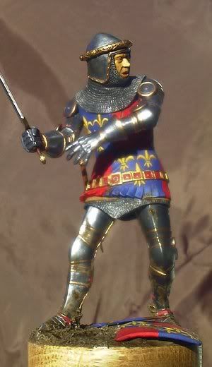

One of the buffable paints like Gunze Sangyo's "Mr metal" would give a good polished look
link
This resin figure's plate work is done with it. buffs up quite well though not tried it or large areas, figure is 120mm tall.

That looks like a king... total guess, is it Henry V?

The coat of arms pin points it pretty closely

Charles I of Albert or Charles d'albret. Constable of France who lead the French against Henry at Agincourt.
Rod there are no lions just the three flur de Les on the blue background of France
