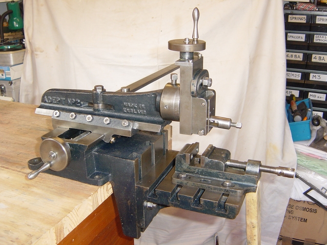

This is an Adept number 2 shaper, like I've got. The Number 1 is smaller:

Will/does it cut steel Neil or is it non ferrous metals only?

Posted by Nige on 07/08/2017 14:36:23:
Anything you want, with 16" lever I can put more force on the tool tip than most hobby lathes. Even the Adept 2 is pretty solid compared to a lathe with a compact saddle/cross slide/topslide arrangement or a typical bench mill with three dovetails again all smaller than the shaper dovetail.
Nige07/08/2017 14:51:19
avatar
370 forum posts
65 photos
Wow. never seen anything like it so surprised at the capabilities!
