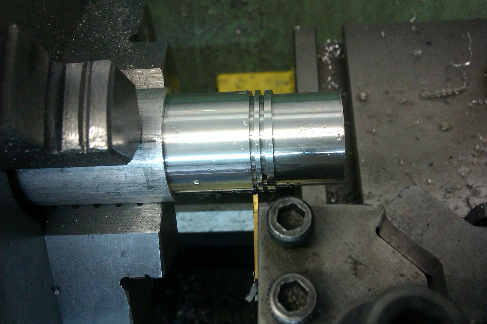

Posted by Hopper on 16/06/2017 00:21:54:
Does nobody grind their own toolbits anymore?
Yes, here's one I made earlier. A 1 mm parting tool for parting a number of parts off 1/8 in silver steel.
I've also made a holder for 1/8 round HSS or silver steel toolbits. The latter can be made very quickly by filing before hardening and finish grinding. The round bits are very good for threading as they can be rotated to suit the helix angle - not my idea G. H. Thomas' idea.
Russell
