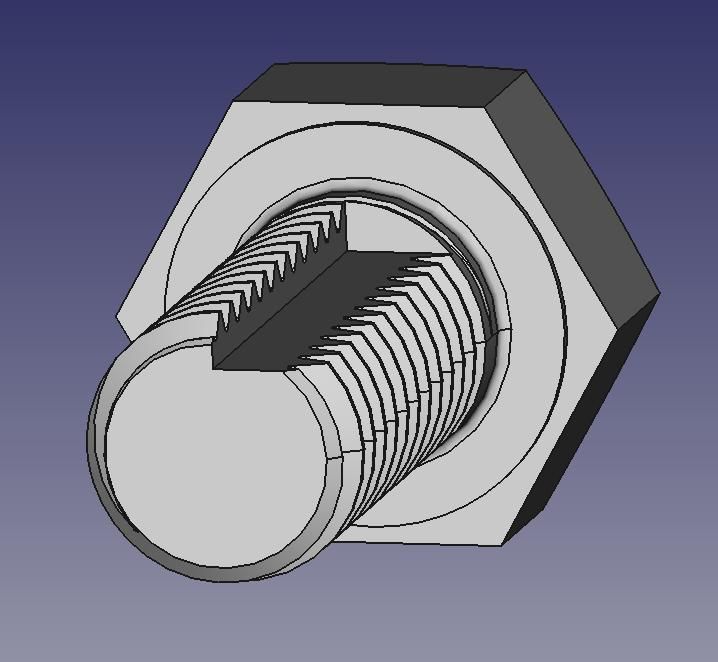

As an exercise I'm making an M9x1.0 threaded component in brass using my lathe only. I've successfully cut the M9 male and moved on to the M9 female.
My first attempt at the female was to develop an M9 tap. This I did by starting by making an M9 bolt out of silver steel and then converting it. The steps were:
  1. The M9 thread was cut on my lathe
  2. The hex head and relief slots were milled.
  3. The 'bolt' was tapered in the lathe to look like a tap
  4. Burrs produced by tapering were gently filed off.
  5. The 'tap' was heated up, held bright red-hot for 2 minutes and then plunge/stirred into a bucket of cold water.
The test piece is a short length of brass rod with an 8mm hole in it. I held the ring in the 3-jaw chuck and attempted the tap. It didn't go well!
After producing some swarf the tap stopped cutting. It feels as if the thread is being ground and progress is very slow. The cuttings are paste.
The picture says it all. Surprisingly the poorly defined thread produced by the tap mates with the male for a couple of turns. It's main fault is that the thread isn't deep enough.
One problem is that the tap is still magnetic, ie not properly hardened after heating and quenching. How did I mess that up?
The other issues must down to the way I've designed or made the tap - the teeth aren't cutting. How should a tap be made?
As always, all advice and comments welcome.

What profile did you mill the slots to, if the edges have ended up with a lot of negative rake you won't get the tap to cut. If you used a ball ended mill then set it to one side of ctr don't mill on the same axis as the tap.

In answer to Jason's profile question here's a CAD mock-up of how I sliced the thread. I used a flat bottomed 4-flute end-mill to cut a slot mid-point on the bolt. I'm not sure that provides enough relief, or enough rake. It's certainly not how real ones are made!
I dunno what I was thinking when I said the tap wasn't hardened because it's still magnetic. Of course it is; the magnetism only disappears when steel is red hot. Doh.

Is it a left hand thread ? The slot shown in the CAD model might work for left hand thread, not for right hand.
SillyOldDuffer12/05/2017 19:46:15
10668 forum posts
2415 photos
Posted by David Jupp on 12/05/2017 19:31:53:
I think you've got it David. Righty-tighty means I've cut the slot on the wrong side!

Looking at your CAD mockup. Even if you had machined it the right way around surely the angle of the cutting face used on the back turn of the tapping motion would push the swarf into the thread rather than cutting it off?
