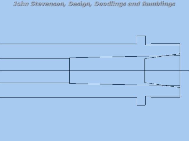

First off and this is just my take on it the only reason for the MT2 in the spindle nose is to run work between centres but the smart set can still do this by leaving the 3 jaw chuck on, placing a bar in the chuck and turn a centre on it and provided that you don't remove said bar then it will run perfectly true and you can use one of the jaws to drive the carrier. Nothing new, people have been doing this for years.
So this is a spare head stock off a ML7 with a MT 2 drill fitted to give an idea of where and how it goes..
Now this is an ER20 collet offered up to a reasonable decent spindle.
And the two compared.
As you can see the thick end of the ER20 is bigger than the MT2 but the small end is smaller than that part of a MT2.
However all is not lost. Seeing as out intrepid hero, Hooper has got a stuffed up spindle to start with he's nothing to loose.
So for your perusal here is a CAD [ clown assisted drawing ] of the spindle with bits superimposed.
Going from left to right in the centre we start off with a nominal 9/16" clearance hole as fitted as standard, this then develops into the MT2 and super imposed on this is the ER20 collet, all drawn to scale.
The ER 20 at the fat end is believe it or not 20mm diameter, so if the spindle was bored to say 22mm diameter for a depth of 1" and a slug of steel pressed and loctited in, then bored in situ at 8 degrees half included angle to accept an ER20 collet, all that is left is to make a new collet nut but with a 1 1/8" x 12 Whit form thread.
Job done and you now have a useful size collet system that can hold any size from 0.5mm up to 13mm.

Now, that's a darn good idea. Thank you Mr Stevenson. Instead a piece of abuse it may turn out to be an improvement after all, with a little judicious fettling! I like the idea of the ER20 collets a lot -- they are cheap as chips to buy online, even the good ones.

If you are doing the ER 20 conversion you will have to bore out to 20mm plus to get the collet in.
[Edit] No forget that it won't matter, too late at night here and any size will do it's just that there will be a transition line somewhere along the ER taper which won't matter anyway.
The ML7 spindle is quite a simple piece of turning in a non exotic steel, I believe they used EN8 left soft on the white metal version and onece you are at this stage it would not be a lot more work to make a new spindle, with a flange.
D1-3 would be well overkill for a 3 1/2" lathe but a straight stepped flange similar to the Chinese C3, C4, C6 series lathes with a simple shoulder, no taper, would be very easy to replicate.
