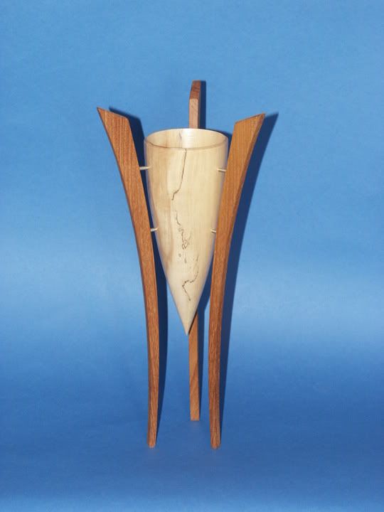

JasonB19/05/2016 20:36:11
avatar
25215 forum posts
3105 photos
1 articles
As Rod says a bit of sawdust won't do much harm if cleaned up afterwards, I've done quiet a few detailed parts as well as pattern making on mine.
And this was knocked out on the Emcomat before I got a wood lathe.
