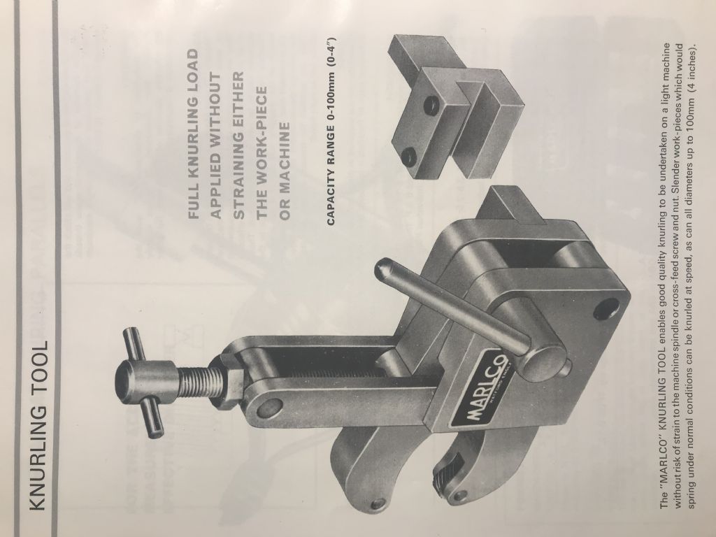

I picked up a clamp type knurling tool today from a sale. It's a substantial thing made by marlco but it's missing the actual wheels. It's a long shot but does anyone know what size wheels I need? and where to get them.

Despite its massive construction, the Marlco wheels are relatively small. You are right that the pin is 7/32"
The wheel diameter is 5/8", and the wheel width is 5/16" (a snug fit in the arm).
They are a joy to use, giving a lovely knurl without effort.
Brian Wood described a modification to fit his Marlco on his Myford lathe in EIM Jul 2014 (Vol 36 No 1) .

I also have one of those Marlcos. The right wheels are Series AJ, 5/8" OD x 5/16" W x 7/32" Hole.

I’m guessing you might find this useful, John : **LINK**

I’ve bought a few Knurls at the shows over the years and they’ve all had 6mm or 1/4” holes for the pins.
John Hall 723/12/2020 11:47:54
90 forum posts
2 photos
Yes 7/32 does seem an odd size...maybe so you could only use wheels supplied by Marlco🙄
John Hall 723/12/2020 11:49:01
90 forum posts
2 photos
The Jones & Shipman tools use 1/4”
