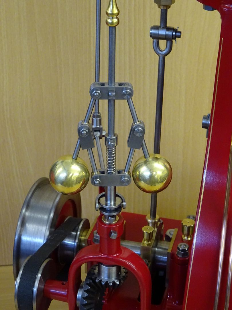

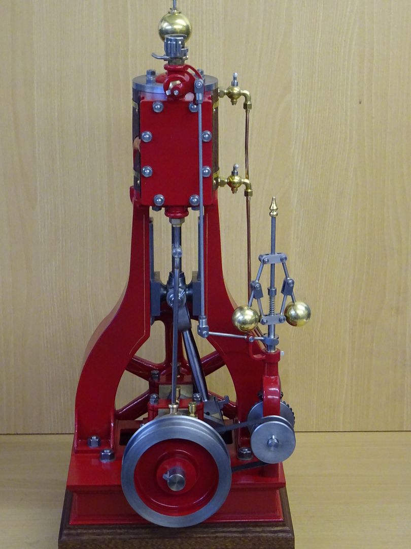

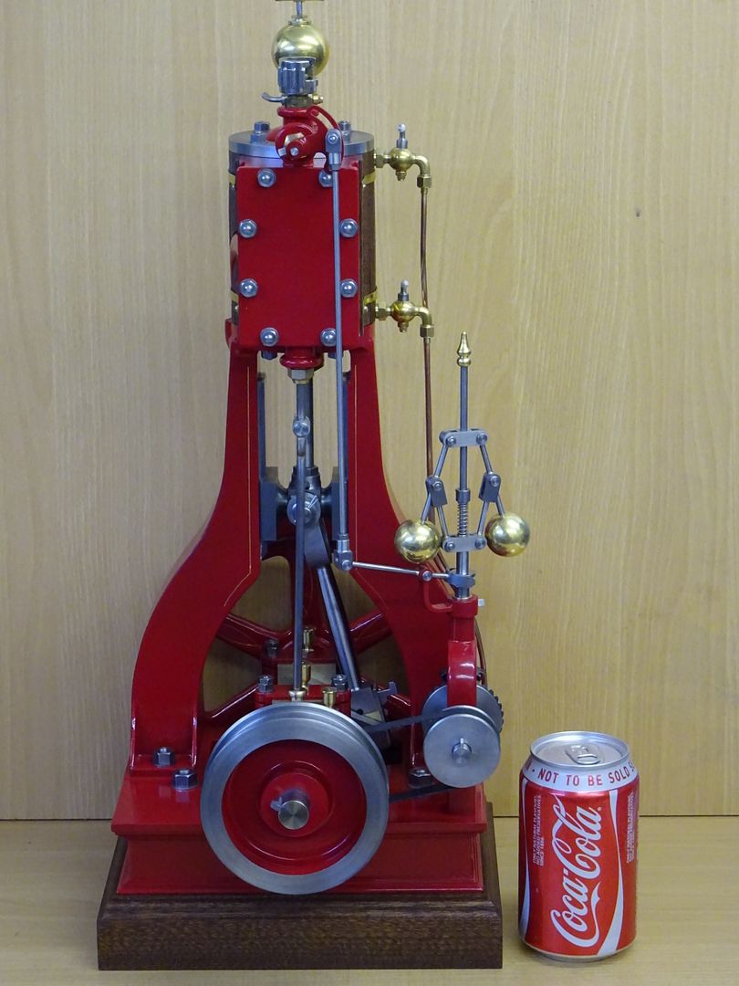

As you may have seen in the Workshop Progress thread I have been physically working on this engine since the end of July, prior to that I made my own set of drawings based on photos taken of an example in a museum and a few others found on the web. As the museum photos came via a Member of ME forum and the Editor acted as go between I feel its only right that I do the full build for Model Engineer but thought I would share a few quick photos of the engine that I finished putting together this morning.
This if the first engine that I have designed from the ground up, others have just been enlarged and enhanced versions of someone else's design. It certainly offers new challenges and is more satisfying to do this way and I can see me doing more of the same.
Apart from a bought in flywheel casting its all fabricated. I also used e-bay gears as at £6.35GBP the pair it just was not worth buying gcutters and materals, governor balls also off e-bay.
I still need to play with the governor a bit as it jumps about at low reves but it is fully working and will keep the speed down to what I have set it at, going to run it in some more and adjust the bearings, big end, gland packing etc as they all bed in.
Big thanks to David Owen for his photos and Diane Carney for her input.
Happy new Year, Jason

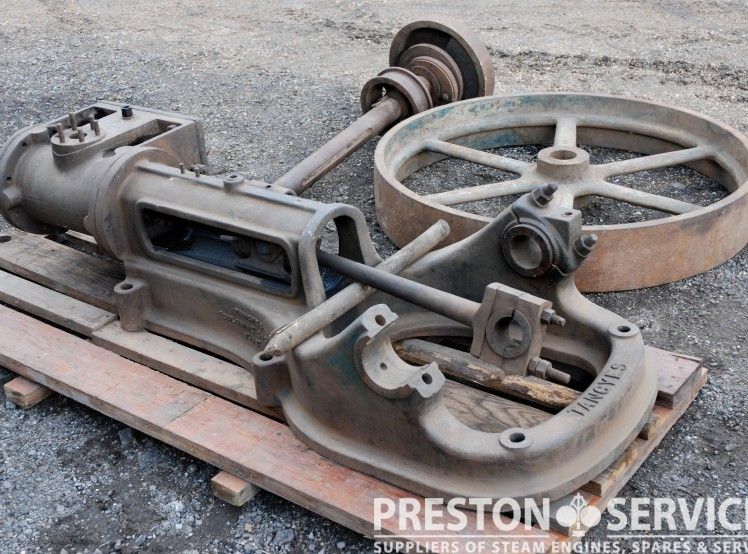

Posted by Ady1 on 01/01/2016 15:19:18:
And your research?
There are Tidman articles/photos in 2952 3449 and 3437 btw
Mostly a very good set of photos with a tape measure in several taken by David Owen, at least one photo from the articles you list, couple of pics from a member of MEM and a few I have found on the web inparticular the one at Hollycombe.
Yes hope to have it at Brooklands. Will have a full set of drawings in the mag if you fancy a gosmiley

Trickiest was probably the "A" frame, keeping it all true and square while bending the metal and welding it up.
A few Facts
Height excluding wooden base 19" , width 8" and 9.5" along the crankshaft
1.625" bore x 3" stroke
115 individual part snot including nuts, washers, studs or lagging planks
Those 115 parts are actually made up from 179 bits of metal, the base "casting" has the highest number of individual parts at 22.

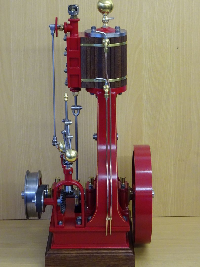

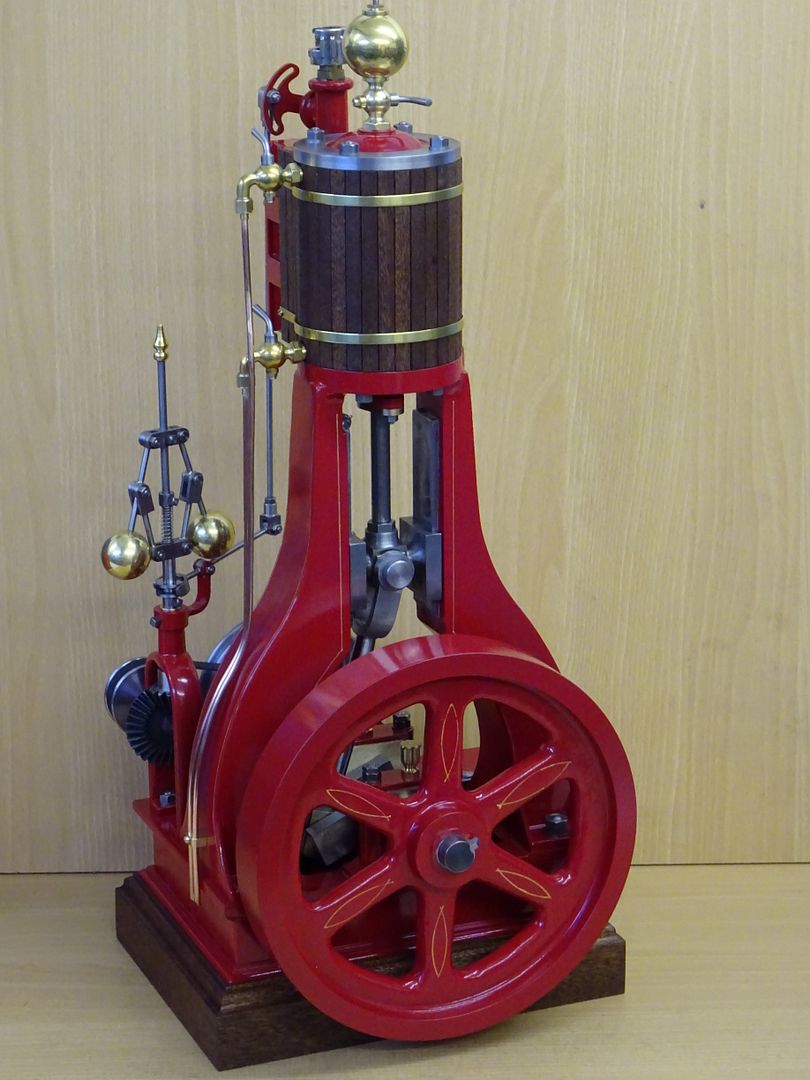

Very nice cladding with grain to scale - what wood did you us?
Rod
JasonB01/01/2016 19:43:30
avatar
25215 forum posts
3105 photos
1 articles
Thanks Rod. I'm not quite decided what the wood is, could be mahogany, sapele or utile. Whatever it is it is old growth as I stripped it out of a clients house that was built around 1910, I got two bits 20" x 2" x 4ft long that were the tops of some shelf units either side of a rather nice arts & crafts fireplace. I've used it for a few of my model bases and it come sup quite well wit either Bona Mega acrylic or for a darker look as in this case I used Ozmo Poly-X.
