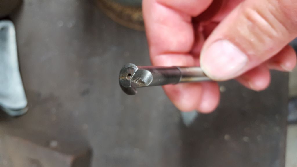

Hi All,
Have recently seen an internal thread cutter, which looked like a snail shell as the cutter. To sharpen it is easy as the degree angle is already set so just a matter of facing off.
Can anybody please tell me what they are called and who sells them.
Regards Ponce

Peter Pearce 112/02/2016 07:35:39
5 forum posts
4 photos
This is the one I have seen. More pictures on ym album.
Regards Ponce.
Hopper12/02/2016 07:55:07
avatar
7881 forum posts
397 photos
Posted by Peter Pearce 1 on 12/02/2016 07:35:39:
Regards Ponce.
Nice idea. Looks like it could be turned out out of silver steel and hardened. The cutout could maybe be done on the offhand grinder.
